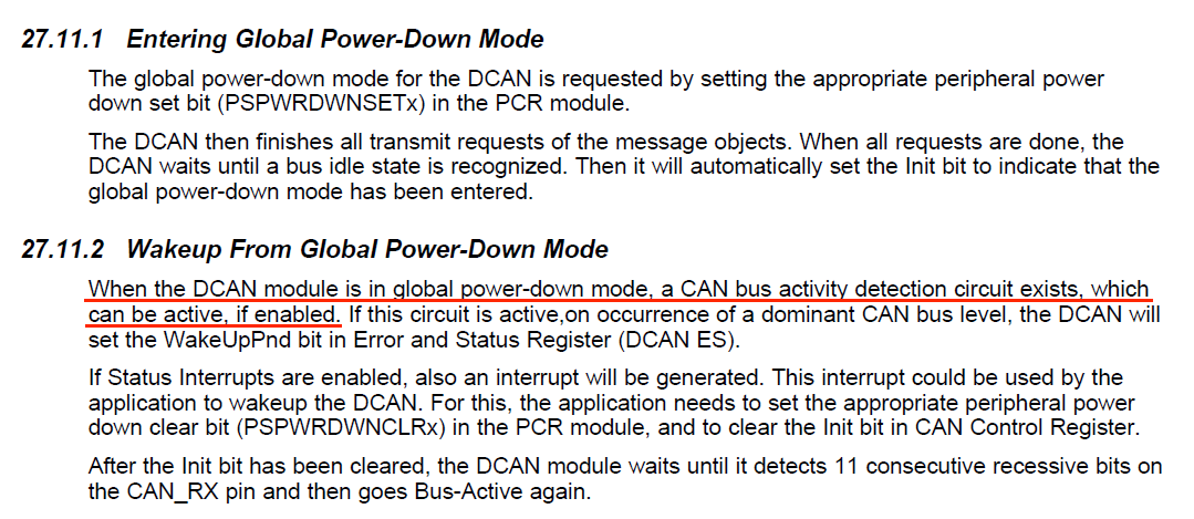

I also have tried Global Power-Down Mode described in TRM (SPNU515C–March 2018, 27.11).
"...it can be active, if enabled". In my case it seems to be active. But how can I disable it?

  • Hello Michat,
    Your observation is correct. The wake up options for sleep low power mode are GIO interrupt, CAN message, and SCI message. RTI interrupt is not able to wake up the device which is in sleep mode since the RTI clock is turned doff.
    As you observed, any kind of CAN message with any ID can wake up the device. All the wake-up interrupts (GIO, CAN, SCI) are ORed into a single wake-up signal to wake up the device.
    If the CAN module is in global power down mode (PSPWRDWNSET), and if CAN bus activity detection circuit is not activated (WUBA), the CAN bus message will not set the wakeup interrupt. If WUBA is activated, any CAN bus level activity (dominant CAN bus level) will generate wakeup interrupt, then your code can start the wake up sequence.
