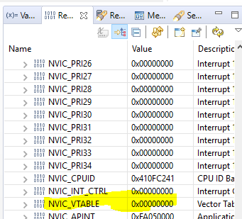

  • I suspect that you do not have the NVIC (nested vector interrupt controller) pointing to your correct vector table. By default, the vector table base address is address 0x0. You can see the base address in the NVIC registers in Code Composer.
    The vector table can be in Flash or RAM. Your link command file is setup for both, so I am not sure which one you are trying to use. I will explain both.
    By default, the vector table is in Flash at address zero. If you want to use a vector table in flash, that is not at address zero, you must write the address of the new vector table to the NVIC_VTABLE register. There is no TivaWare function to do this, so it would be done with a direct register write:
            // Point the NVIC at the new Flash vector table.
            HWREG(NVIC_VTABLE) = 0x2800;
    You move the vector table to RAM when you call the TivaWare function IntRegister(). This function will copy the vectors pointed to by the NVIC_VTABLE register into the RAM section ".vtable" (unless it is already pointing there) and then replace the one vector which you are registering.
    If you mix the two methods in application code that runs with a bootloader, you must use the HWREG write of NVIC_VTABLE before calling IntRegister(). That way the IntRegister() function will copy your application's vector table from flash to RAM instead of copying the bootloaders vector table.
    There is more information about the difference between vector tables in flash compared to RAM in section 17.1 of the TivaWare Pericpheral Driver Library User's Guide. (C:\ti\TivaWare_C_Series-2.1.4.178\docs\SW-TM4C-DRL-UG-2.1.4.178.pdf)

  • Hello Bob,
    Thanks for a really detailed response.
    I am using the flash nvic table and my application is linked to have the table on 2800.
    I tried setting the nvic table to 2800 as well but my interrupts are still not firing.
    Right now I am testing the application in isolation(without the bootloader) on ccs would that also create problems or the serial bootloader is not equipped to do the nvic table offset change?
    Tuna Bicim
  • Even without the nvic table jump the program works now.
    I think when testing on debug mode without the bootloader the example was going to fault when interrupts hit.
    I also tested on debug with the nvic table change and everything runs unless there is a reset and then same behaviour happens which makes sense because table goes back to 0x0000.
    I also tried using IntRegister but for some reason it didn't work for me. Maybe I did something wrong.
    Thanks again for all the answers.
