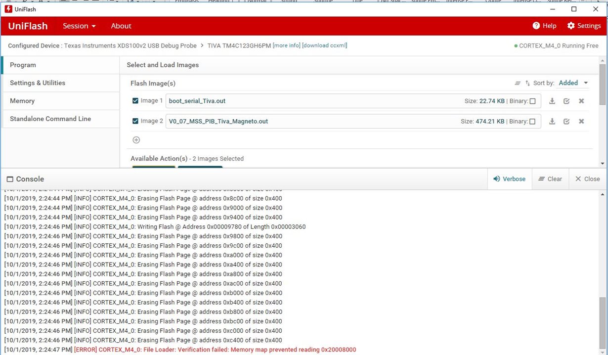

I am trying to program the Tiva TM4C123GH6PM part using Uniflash 5.1.0 GUI.  When it completes the programming, it attempts to read address 0x20008000, which is reserved memory, so an error is generated.
If I create a standalone command line version, it programs WITHOUT the error being generated.
I need to use the GUI.  Both methods *should* behave identically.

  • Below are the contents of the linker .cmd file.  Please note that nothing is mapped to 0x20008000.
    You original post shows two images being flashed - boot_serial_Tiva.out and V0_07_MSS_PIB_Tiva_Magneto.out. Which of the two images is the linker .cmd file from?
    Agree, but STACK_SECTION from addresses 0x20007000 ... 0x20007FFF with a fill ends just before the address 0x20008000. I had a go at creating a single image which had a stack fill to end of RAM but couldn't repeat the error with Uniflash 5.1.0.2397.
    Under the Uniflash options can you enable Debug Server Logging and attach the log file from when the error occurs? That might reveal why Uniflash is trying to read from address 0x20008000.

  • I agree that the mappings are not correct, but we are using the boot_serial_Tiva.out file with multiple processors.  And since the maximum RAM and Flash is not being used, these lines are not an issue.
    The issue is with the following line:
    STACK_SECTION (RW) : origin = 0x20007000, length = 0x00001000, fill = 0x1234
    If I change the length to 0x00000FFF, then it programs without any errors
    STACK_SECTION (RW) : origin = 0x20007000, length = 0x00000FFF, fill = 0x1234
    The original line is correct and valid.  It is filling RAM from 0x20007000 - 0x20007FFF with the value of 0x1234.
    I program these files all the time with CCS v5.5 and there are no issues.  Somehow Uniflash thinks it is trying to go from 0x20007000 - 0x20008000.

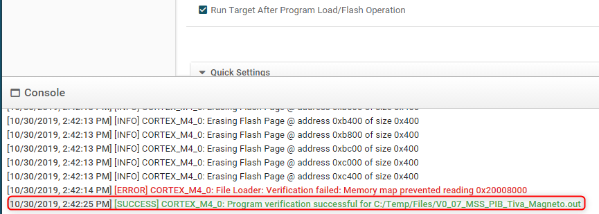

  • Thanks Nelson. I got them.
    The error seems to be coming from V0_07_MSS_PIB_Tiva_Magneto.out. When I load that one, I get the verification error.
    The odd thing is when I load the same file with CCS 9.2, with FULL verification on, it is successful. When I manually run a full verification on the file afterwards, it succeeds again.
    Now the weird thing is that the after the error in UniFlash, when I run a manual verification, it is successful!
    I'm not sure why Uniflash is getting the issue just on the program load (while the subsequent manual verify step succeeds). Your ds log certainly shows uniflash trying to read that address on load.
    I will need to escalate this to the engineering team for more analysis. I will keep you posted
