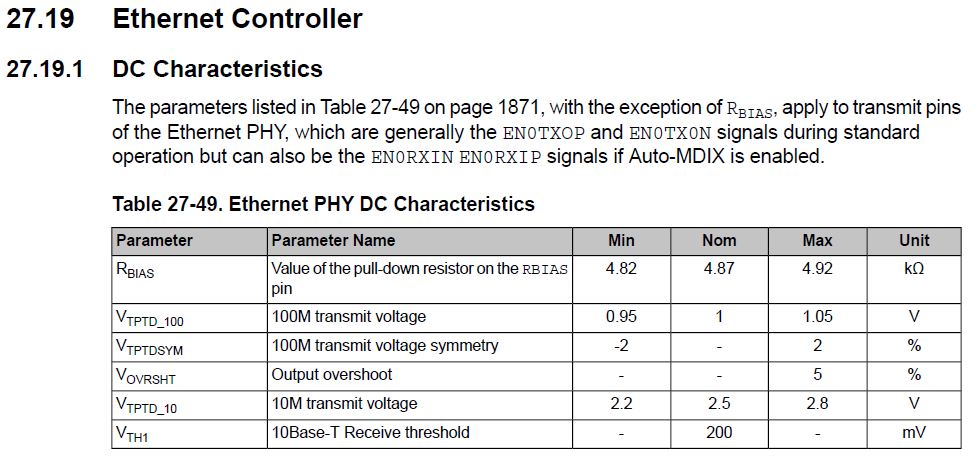

Hi Sir,
If TM4C1294KCPDT supports UTP mode, which one is its drive mode,current or voltage?

      Please elaborate what you meant by UTP mode and in what context. I suppose UTP as in un-shielded twisted pair, correct? If the understanding is not correct, then what is UTP you are referring to? Do you mean if the TM4C129 supports Ethernet? TM4C129 has the built-in Ethernet PHY which outputs the differential signals. All the PHY parameters are documented in the datasheet if this is what you are looking for.

          I have not heard back from you. I assume you are asking for differential signals on the device. Both the Ethernet and USB output differential signals and their electrical parameters can be found in the datasheet.  I will close this thread for now. If you are asking a different question, you can elaborate your question to this post again to reopen the thread.
