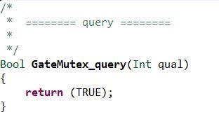

    After creating that I called IGateProvider_query to get the quality. I got always TRUE as the return value even though I passed different qualities to check. To know that I started debugging. When we call IGateProvider_query function it will go to below function only.
    This function available in C:\ti\xdctools_3_32_01_22_core\packages\xdc\runtime\IGateProvider.h location.
    In this __inst->query is points to the GateMutexPri_query and GateMutex_query only (Refer below).
    Location for above two functions
    C:\ti\tirtos_tivac_2_16_00_08\products\bios_6_45_01_29\packages\ti\sysbios\gates\GateMutex.c for GateMutex_query function.
    C:\ti\tirtos_tivac_2_16_00_08\products\bios_6_45_01_29\packages\ti\sysbios\gates\GateMutexPri.c for GateMutexPri_query function.
    These functions will always return TRUE only. I Put the breakpoints in those functions and checked.
    If this is the case means how we will get the exact usage of quality?

  • Iyyappan,
    Both GateMutex and GateMutexPri can "block" the calling task (call it TaskA). By "block", I mean that some other task could have already entered the gate, so TaskA will block on the semaphore in the GateMutex_enter (or GateMutexPri_enter) call.
    Similarly with the "preempting" quality. Let a task (call it TaskA again) own the gate (e.g. has successfully returned from GateMutex_enter (or GateMutexPri_enter or IGateProvider_enter)), if a higher priority thread (e.g. Hwi, Swi or higher priority Task) becomes ready to run, that higher priority thread will preempt TaskA.
    When are cases where the query returns false? GateHwi disables interrupts in GateHwi_enter. So when the running thread calls GateHwi_enter, it will not block since it is the running task. Once you return from GateHwi_enter, the thread that owns the gate cannot be preempted since all interrupts are disabled (and you should not be making kernel calls that impact the scheduler while you own the gate).
    We made the query functions in case you just have a IGateProvider_Handle and need to know more about it before using it.
    Todd

  • Hi lyypappan.
    No. These are read-only qualities of the GateMutex and GateMutexPri modules.
