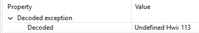

I got the following exception.
If watchdog is disabled it working fine.
Please check the attached exception detailes.

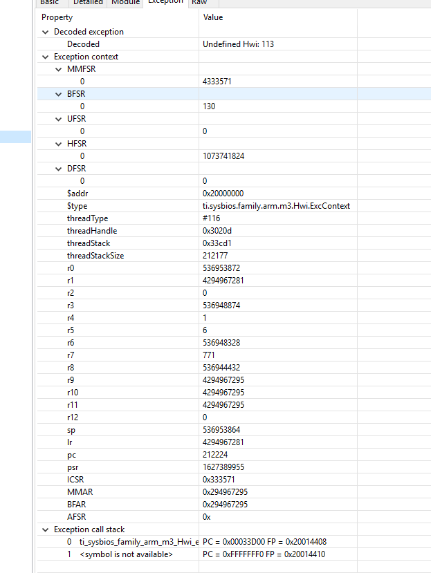

    My Exception number is 3 and fault detailes are
    TiRtos version is : 2.16.0.08
    Nikhil
  • It looks like int 113 is INT_LCD0. Are you (or some other code) doing anything with this? Can you open the disassembly window and add IntRegister? Does it show up? If so, put a breakpoint at the beginning of the function and restart the application. Who is calling this function?

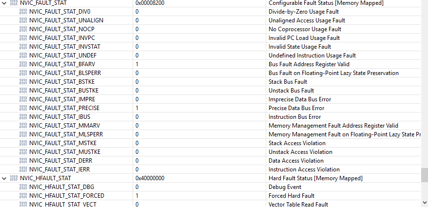

    If I commenting watchdog portion result will be like this.
    Fault address detailes also attaching. But using this address also I cant locate the the code which cause the exception.
    Nikhil
  • Hi Nikhil,
    Does your call to Hwi_create return successfully? Or does it get an exception before that? Also, you said in your first post that it worked if you didn't use the watchdog, but is that not true anymore according to your last post?
    Can you open your applications .map file and see if there are any interrupt registering functions being pulled into the application? You may have to search for 'int', 'interrupt', 'register' etc. If there are such functions, that would be bad as TIRTOS must manage all interrupts for it to function correctly.

    Actually issue is due string descriptor variable is in local scope.
    When its scope changed into globally issue is resolved..
    Thanks for the support.
