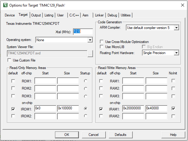

    I am using TM4C123GXL and Keil IDE to generate a formula.I had initialized array which has 5000 elements.  And I used qsort function from the c library.  But when I tried to run this code without qsort , the code is working. (it is working so slow).  After I open the qsort function the program is going to an endless loop called hard fault handler and waits at the instruction B and also I can`t able to stop this instruction.

       Every time a function declares a new local variable, it is "pushed" onto the stack. 5000 elements will take up quite some memory space. What is the size of each element (i.e. 8-bit, 16-bit or 32-bit)? How much stack did you declare? Is your qsort function recursive? If each element is 32-bit then just the 5000 elements will take up 20kB of memory let alone other variables you might declared in the same function. Please bear in mind that there is only 32kB of system memory in the device. How much memory does the metro m4 have? Perhaps it has more system memory than TM4C123.

    The size of each element is 32 bit (integer).  My qsort function recursived to qsort the array has 500 element (almost 5000 times)  The metro me4 has 192 kb ram.
    You can find the compiler settings in the attachment or above.  I tried to compile and test on Keil and ccs. But the problem repeated.

      What is the stack size you declare? It doesn't show on your screenshot.
      I don't know exactly how many elements are pushed onto the stack. 500 elements recursively called 5000 times will can easily overflow the stack. As I noted before there is only 32kB of SRAM on this device.

    I changed the stack size from startup_TM4C129.s file. Firs value was 0x0000200 and I updated as 0x1000. I increased five times.
    ; <h> Stack Configuration
    ;   <o> Stack Size (in Bytes) <0x0-0xFFFFFFFF:8>
    ; </h>
    Stack_Size      EQU     0x00001000    ; it was 0x200
                    AREA    STACK, NOINIT, READWRITE, ALIGN=3
    Stack_Mem       SPACE   Stack_Size
    __initial_sp
    And the problem is solved. The device is working in spite of slow. I guess I need to change the main clock frequency to works faster. How can I change the main clock frequency to work faster?
