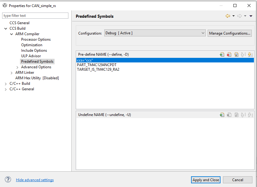

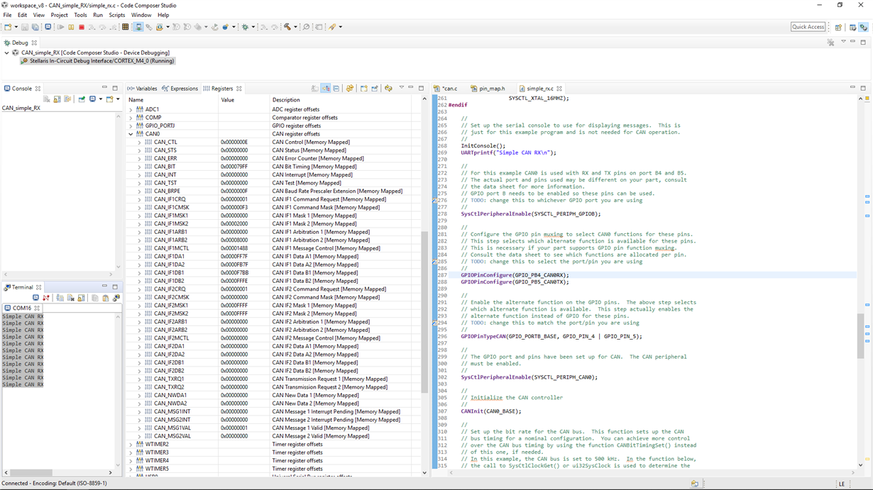

I want to read data from my encoder (CAN) and I'm using EK-TM4C1294XL & TJA1050. Also I'm using CAN_simple_RX but i can not read data.

  • I changed the pin names but does not accept.
    "../simple_rx.c", line 241: error #20: identifier "GPIO_PA0_CAN0RX" is undefined
    "../simple_rx.c", line 242: error #20: identifier "GPIO_PA1_CAN0TX" is undefined
    I checked the pins on pin_map.h and TI PinMux Tool. It must be correct but i got errors.
  • Do you have the proper part definitions in your project? They should look like this:
