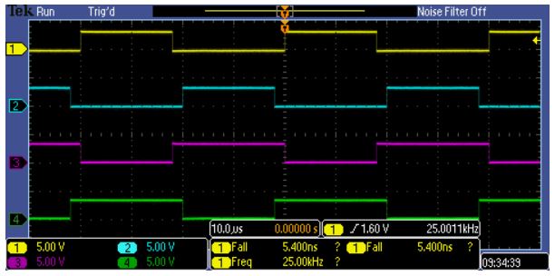

    This scope-cap - along w/careful read/review of poster's 'declared objective' - should clarify.    Note that shown here are the outputs from 2 PWM Generators w/the 2nd Gen simply inverting the output of the 1st Gen.    And that produced  'Unusable power stage control signals!'    (i.e. Destructive control signals - as channels 1 & 4 along w/2 & 3 'drove high' - at the same time.)    (Read deeper into that past post for detail... and an outsider's 'inventive solution.')
