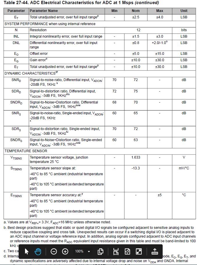

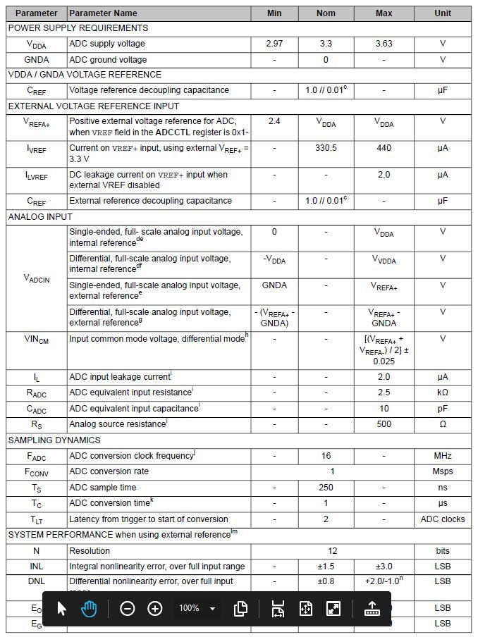

TM4C1294NCPDT: request for ADC circuit detail design
Part Number: TM4C1294NCPDT
  1.  the ADC leakage current?
  2. The Min. ADC sample capacitor value?
  3. Analog input pin protect circuit  topology structure?
  4. When the input voltage is higher than the spec, what is the max input current?
           If you have the ADC detail design guideline , please share to me,
