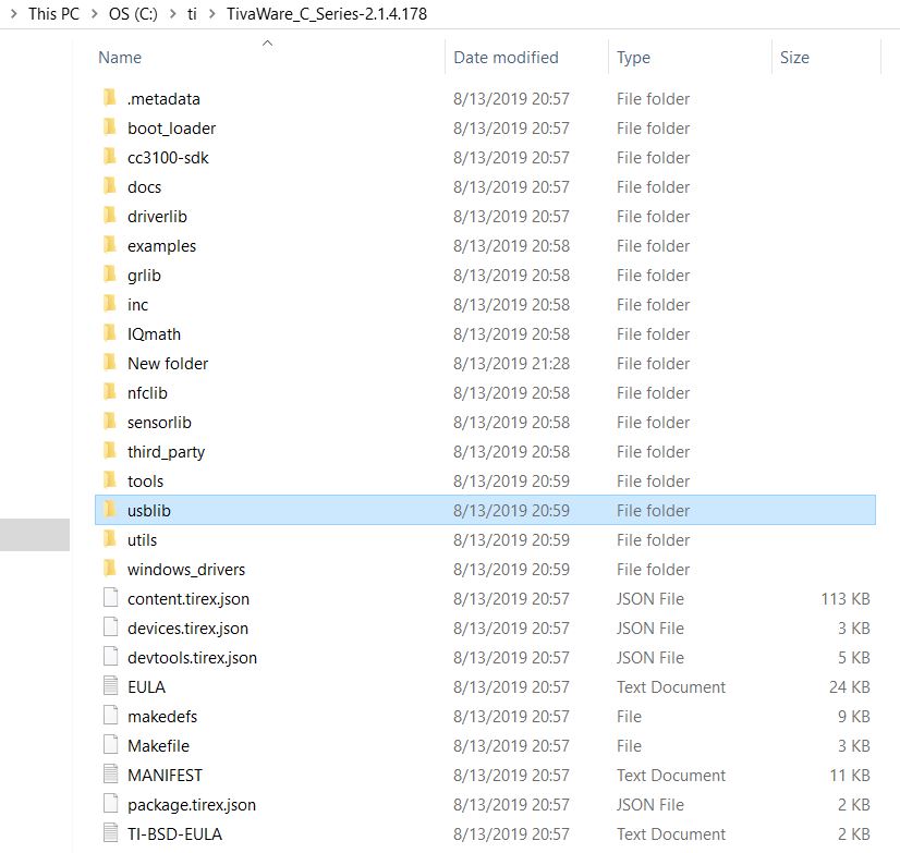

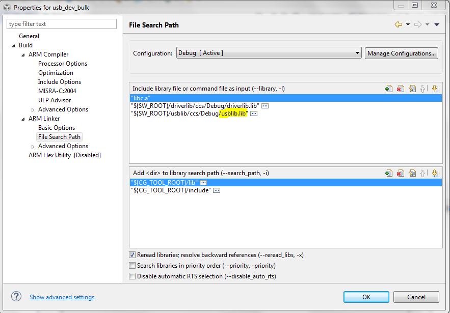

I have installed the tivaware usb library, and I'm reading the .c and .h files in order to understand how it works. However there is an important file that I can't open : usblib.lib.
Where can I find this file in the .c format?
