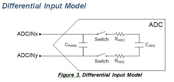

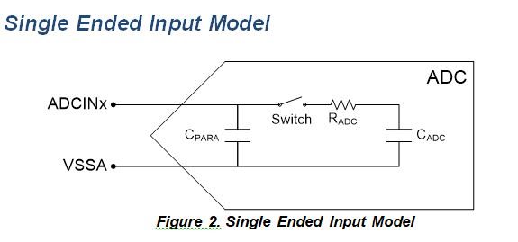

     That is not possible. Each ADC core can only convert one channel at a time. In differential mode, an even channel X can be coupled with channel X+1 to form a differential pair. However, the the still has to be converted in sequence. One might tries to feed the same channel to two different ADC cores and perform conversion in parallel but that will be single ended input mode only.  Sorry, typing with my phone is not the most convenient way to support the forum. :)

      I'm very sorry that I gave the wrong information concerning differential mode.  cb1 is absolutely right that it does not make any sense in differential mode the two differential inputs are converted in sequence. It just defeats the purpose of the differential mode to reject the common noise entirely. I'm still trying to understand exactly how the differential mode works. I doubt two ADC cores are used at the same time. I tend to think in differential mode only channel x is converted while using channel x+1 as a voltage reference. How it is exactly done, I don't know yet.  I will get back once I confirm the intricacy of the differential mode. Once again, without cb1's relentless pursuit, I would not have known the big mistake on my prior answer.
      The differential throughput in my opinion will be the same as in single-ended at the expense of using two channels instead of one.

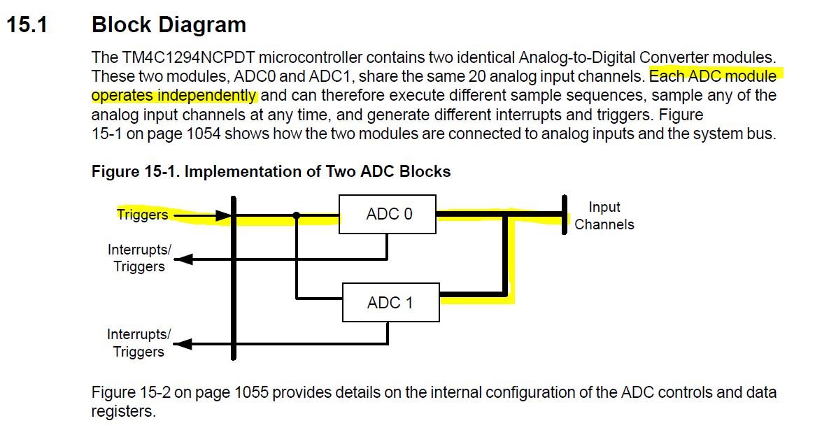

  • Patrick Emerick said:
    ... working on a project which requires one ADC Peripheral to continuously sample at maximum sample rate while sampling a few differential signals with the other ADC Peripheral.
    Follows now the apparent 'Rules/Regulations' which impact the ADC's Differential Analog operation:
    • There are 2 independent ADC Modules - each one includes an 8 Channel MUX.    The Mux likely prevents two ADC Channels - w/in the same ADC Module - from being simultaneously converted.
    • The API functions: 'ADCSequenceConfigure() & ADCSequenceStepConfigure()' each enforce, 'All Sequenced Channels' to reside w/in the same ADC Module.   Thus - it would appear - that the MUX forces the unwanted Delay between each of the Differential Channels.   (i.e. the Mux can only feed the input analog signal to one channel at a time.    Thus - even if common clocking can be achieved - the 2nd analog channel is 'unavailable!')
    These key factors  (above)  are documented via the TM4C123's Manual as follows:

    Differential mode only works with adjacent channel pairs (for example, 0 and 1). The channel select must be the number of the channel pair to sample (for example, ADC_CTL_CH0 for 0 and 1, or ADC_CTL_CH1 for 2 and 3) or undefined results are returned by the ADC.
    Both of these, 'Sequencing Configurations'  confine Channel Selection to the 'Specified ADC Module - only!'    Again - this suggests that an unwanted, error introducing delay will be inflicted upon the Differential Signal's Measurement.
    Minus 'insider knowledge' - or 'inspired experimentation & measurement' (via the suggested, Linear Ramp, Voltage Application) the 'Real Workings' of the Differential Conversion remains unknown.
    It is possible - that unless the MCU's internal signal routings prevent it - a, 'Re-Write of (each) of the ADC's Sequencing Configuration APIs  (remove the Single ADC Module Restriction) may enable (quick & eased) - yet (then) proper Differential Signal Conversion!

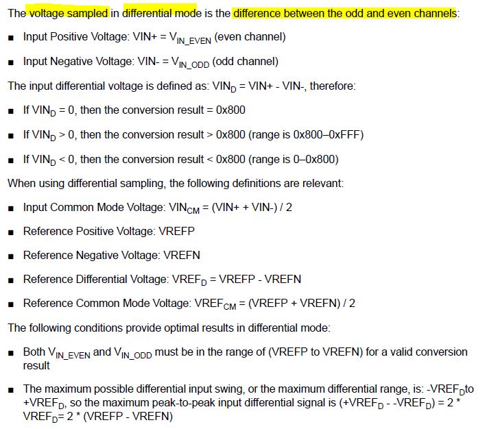

    which, is interpreted by me to mean that each ADC Peripheral can convert one channel so, if triggered simultaneously, together they can convert two channels simultaneously. As far as I understand it, each ADC Peripheral has an independent input channel MUX so, each MUX can be configured independently.
     Hi Patrick, your understanding is correct Please see below description and diagram. The analog inputs are routed to both ADC modules in parallel and they share the same trigger. If you use a trigger event (i.e. Timer) then it can trigger both the ADC module to convert at the same time.
    Please also try the differential mode using just one ADC module. It will be easier to setup just one ADC module rather than 2. There is a differential mode example under <TivaWare_Installation>/examples/peripheral/adc/differential.c.
     About the incorrect information I provided earlier, I want to apologize again. Please refer to the datasheet as it clarified how the differential mode works. As it says, the voltage sampled is the 'difference' between the odd and even channels, not odd and even in sequence.
    Again (pardon) - but 'UNLESS THE 'ODD & EVEN CHANNELS' ARE SIMULTANEOUSLY CONVERTED' - THE  DIFFERENTIAL MEASUREMENT REMAINS FLAWED!

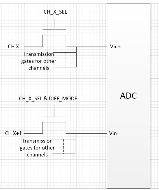

  • Hi cb1 and Patrick,
      I don't have the analog ADC schematic with me. I will suppose the analog ADC core takes Vin+ and Vin-. When in single-ended mode the Vin- is referenced to the GND. In differential mode both the differential inputs are connected to the Vin+ and Vin- simultaneously. I think a lot of the confusion arises from my earlier incorrect explanation.
    Yet there REMAINS the MUX - and in my 25+ years of Mux Usage - never have I (or more clever others) been able to 'Tease the '1 of N' Channel Mux'  to (simultaneously) Connect TWO Channels!
    Is not the MUX there to 'Reduce Components' (thus device size/cost)  -  and accommodate an (essentially) SINGLE Channel Conversion Methodology - which is (most always) 'TIME DIVISION MULTIPLEXED!'    (I.E. SEQUENCED!)
    WHAT am I MISSING?
  • Hi cb1,
      I understand your question. Again, I will suppose there are two multiplexers (implemented as MOSFET transmission gates) in place for the differential mode to work. When in differential mode the channel x is selected and the channel x+1 is automatically selected when channel x is selected provided differential mode is activated. I hope my simplified drawing makes sense.
  • Hello Charles,
    Your special (added) effort IS appreciated - thank you.
    That said - that 'mystery' 2nd "Ch_X_SEL & DIFF_MODE" implementation is described 'NOWHERE' w/in your MCU's (past: LM3S, LX4F; & TM4C) documentation.    Might this methodology have been implemented w/in 'Higher Performance MCUs' -  which you (may have) employed?
    Do keep in mind - there are 'Multiple Differential Signal Pairings' - (4 such pairings are possible) - does that not (substantially) further complicate such an implementation?     (i.e. As EACH/EVERY ADC channel w/in the MCU must have such (switchable access) -  to these 'transmission gates.'     As a past Tech Mgr @ another 'semi-giant' - such an implementation rings  (at least to me, here/now) as, 'Inefficient & Unusual.'
    Should such 'Transmission Gates' exist - and prove successful - does this not render the 'ADC MUX' (essentially) superfluous?'
    Note too - the 'Transmission Gate Control' must have clear knowledge of:
    • Not only the Differential Pair selected
    but of
    • The position of each Channel w/in the ADC's Stepped Sequence  (You have earlier advised that these may not be forced, 'Back to back!')
    Pardon - as the MCU's internal structure must devote 'So many (expanded) design & implementation resources'  - to the (suspected)  very minority usage of 'Differential Conversion' - I remain a, 'Disbeliever!'

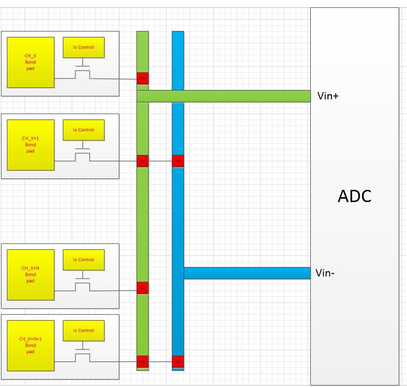

  • Hi cb1,
      The switch will be part of the I/O. I try to show multiple I/O in the I/O ring. The green and blue are the routing wires. The red is the via.
  • Hi Charles,
    Again - your focused effort IS much appreciated - that's for sure - staff/I thank you.
    However - there appear (at least) TWO  'Unanticipated/Unfortunate  Consequences/Realities:'
    • If what you state proves true - would not the Differential Conversion Mode run at TWICE the Conversion Rate?    (As 2 Channels are 'simultaneously converted!')
    • And - should that 'Two Simultaneous Conversions Capability Exist' -  Why 'Limit It to JUST the (lesser used) Differential Conversions?'
    (edit):  I earlier (above) clearly 'MISSED' the fact that, 'the 2nd Differential Analog Channel is being fed to Vin(-) - Not to a 2nd Analog Channel!    ('missed' may prove overstatement - as Charles' (just arrived posting) was the 'Very First revelation' of this resourceful Differential Conversion implementation!    (i.e. Feed the Odd Numbered Differential Channel to 'Vin(-)' - rather than a separate analog channel!)
    I do believe that '4  (minimum) such Channels should feed Vin(-)' - not just the 3 shown!    (this as there are '4 Channel Pairs' available for Differential Conversion - and each of those 4 (independent of the feed to Vin(+) ) - must have a pathway to Vin(-) !)
    In addition - thinking further - is it not true that, 'ALL Even numbered Analog Channels' must employ the identical (i.e. GATED means) to connect to Vin(+)?     And - if that's so - the same holds for 'ALL  Odd numbered Analog Channels' (i.e. connect them (potentially) to Vin(-) ) - as well!    (Can you say, 'Urban (or MCU) Sprawl?')     Thus the drawing above (may) benefit by 'further detailing' the ACTUAL NUMBER of Gating Elements - placed between - (both) Vin(+) and Vin(-)!
    Is it not true - that each/every analog channel (if there are an even number total of such channels) must 'be blessed w/a Gating Path to (either) Vin(+) [when even numbered] and Vin(-) [when odd numbered?']    (should there be an odd number total of analog channels - that last (even) channel (i.e. highest channel number) - has NO paired channel - thus escapes the need for such gating!)
    We should note the ramifications of Charles' excellent, in-depth presentation:
    a) the Differential Analog Conversion Rate is the same as that of 'Single Ended' - thus NOT 1/2 of the Single Ended Rate - as earlier (erroneously) 'Marked as Verified!'
    b) the Differential Conversion design shown - providing all of the gating circuitry between (both) Vin(+) and Vin(-) is 'well matched' - should prove 'proper & effective' - which was, 'Far from the case when Use of a 2nd Analog Channel' (rather than simply feeding Vin(-) ) was (earlier) declared/suspected.
    c) the presence of 'Four such  'Vin(-)' Gate Control Circuits' (not the 3 shown) (potentially) subjects the Vin(-) input to 'crosstalk' - even when - especially when - only single-ended usage is employed.   (i.e. (some) leakage/bleeding between those "held-off" channels is likely to occur...)
    Staff & this reporter are (greatly) in debt to Charles for his 'Deep Dive' into these necessary circuit facts - never presented (to our best knowledge) w/in TM4C (or LX4F) documentation...   Thank you, Charles!

    Further detailing to aid the understanding of the (few posts earlier) Differential ADC Diagram:
    • It must be true that 'ALL ODD ADC CHANNELS' CAN POTENTIALLY CONNECT TO VIN(-).
    • It is realized that only 'One Odd Channel' will be connected to VIN(-) at any one 'Diff Mode Time.'
    • It must also be true that 'ALL EVEN ADC CHANNELS CAN POTENTIALLY CONNECT TO VIN(+).   (Unless the channel total is odd - in that case the highest even numbered channel (may) [hedge alert - this remains beyond logic] NEVER connect to VIN(+)!    (as it has no 'Paired Channel' - yet still must be able to access VIN(+) during 'Single Ended Mode.')
    • It is realized that only 'One Even Channel' will be connected  to VIN(+) at any one 'Diff Mode Time.'
    The drawing gives the impression that 'FAR Less is Going on.'    It must be that many Gates and/or Muxes have, 'Entered the Building.'
    It is hoped that this (new) detail (pure yet (somewhat SWAG) - generated by my group alone - aids comprehension...
    Note that the Measurement of 'Differential Analog Signals' (especially due to 'Differential's Ability'  to reject common-mode Noise) is (almost) certain to,
    • 'Enhance ADC Accuracy'
    • and (even)  'Reduce the number of 'PCB Layers' from (likely) 8 or 6 - to just 4!
    It is for these 'Pay Offs' - that my group 'So Persisted!'
  • Hi cb1,
      I fully agree with your assessment. I will just add one clarification highlighted in red. The reason is that all odd channels can be selected for singled-end mode in which case they need to go to Vin+.
    • It must also be true that 'ALL EVEN AND ODD ADC CHANNELS CAN POTENTIALLY CONNECT TO VIN(+).   (Unless the channel total is odd - in that case the highest even numbered channel (may) [hedge alert - this remains beyond logic] NEVER connect to VIN(+)!    (as it has no 'Paired Channel' - yet still must be able to access VIN(+) during 'Single Ended Mode.')
  • Hello Charles,
    Indeed you are correct - my focus upon the 'Differential Mode' led to my miss.    I am pleased that the remainder of my Summary - met w/approval.
    My intent was that such listing would add clarity - and provide a 'deeper glimpse' into 'What's really occurring' deep w/in the silicon.'
    Again - your 'Above & Beyond Investigative Efforts' - for (it is believed) the first time here (or in LM3S/LX4F/TM4C Literature) has substantially added to the, 'Understanding of the ADC's Operation while commanded to 'Differential Conversion Mode.'
