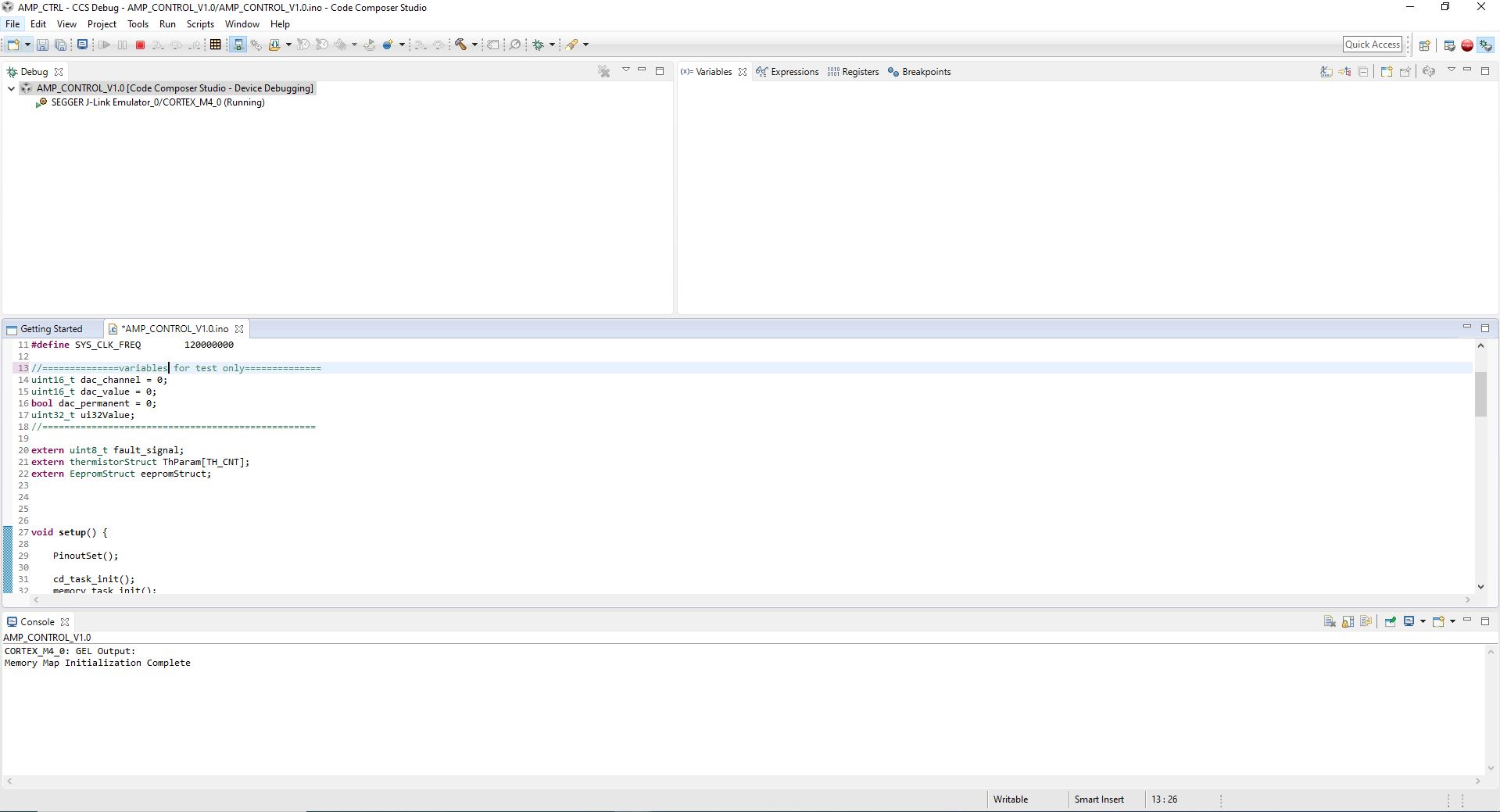

    I know that is not an error but this is the reason why I couldn't explain the problem - there isn't an error message and yet it's not run as expected.
    There are many reasons why this could be the case. It could be that the correct debug context is not selected. Again, it is hard to give good suggestions without more details. Provide a screenshot the whole CCS IDE GUI when this happens

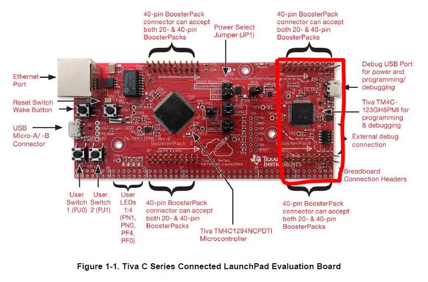

    I'm using the evaluation kit as debugger to an external target according the next configuration:
    - Jumpers to bridge from ICDI to Target portion of LaunchPad were removed
    - PC connected to debug USB port
    - JTAG_ARM_10PIN connected to an external target
    - At CCS: project -> properties -> CCS general -> Connection: Stellaris In-Circuit Debug Interface
    At this case I succeses to program and debug my project, when I'm switch the evaluation kit with J-link (and choose SEGGER J-link Emulator in connection field) it's stuck  as showen in the screenshot above.
  • Thanks for the screenshot. I can see that the proper debug context is not selected in the Debug view. If you select the node below the current context (the one that starts with "SEGGER J-Link Emulator"), then the button to suspend the processor will be available (since the CPU is already running). Once the CPU is halted, the resume button will be available.
    The question now is if the program is running successfully. It seems unlikely since you mentioned there is an issue with J-Link. If you have a 'main' in your program, but you are unable to reach it, then you will see similar behavior since the program will just run forever.
    Assuming that the above is the case, the next question is why doesn't the program reach 'main'? If you are loading the same out file between the debug session using the Stellaris ICDI connection and the J-Link connection, then the out file must be fine. Perhaps the J-Link target configuration is missing an initialization step? Check to see what startup GEL file is being used by the J-Link configuration. It may be different than the one used by the ICDI configuration. If they are different, check to see what the differences in the GEL files are.

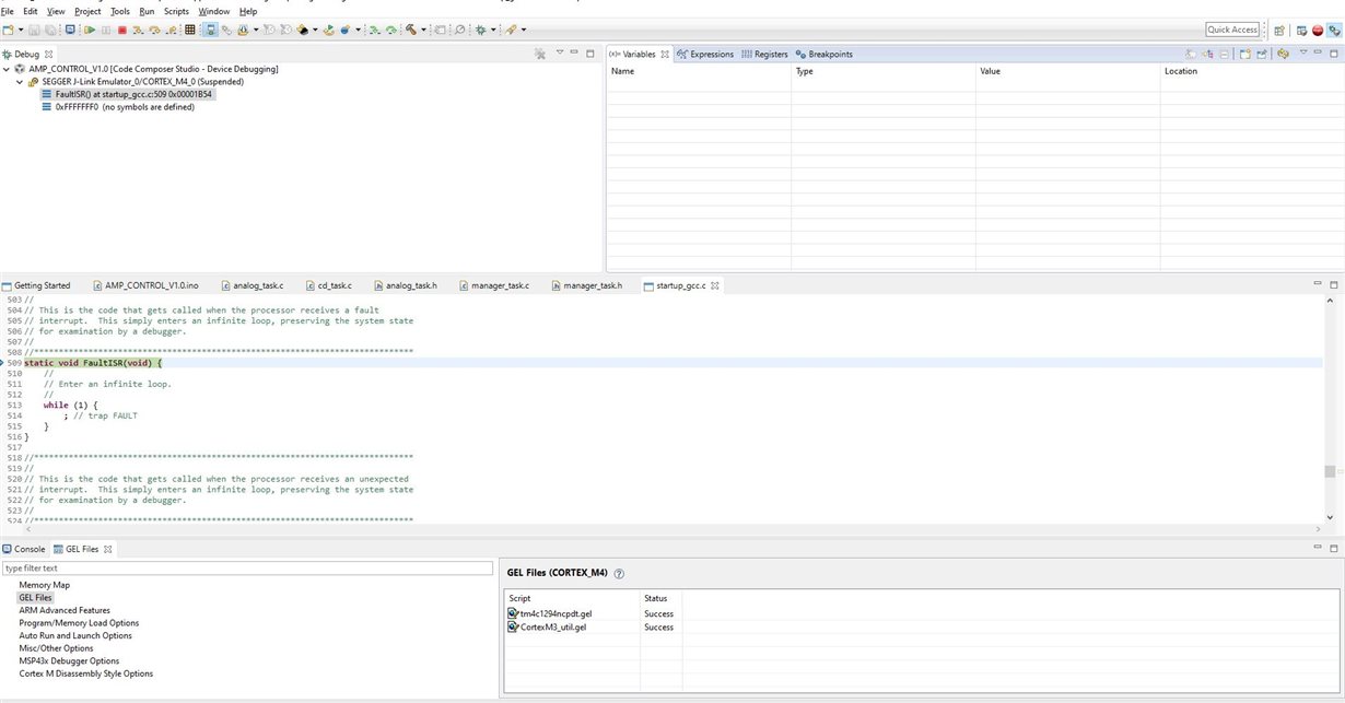

  • Thanks, I selected the right node and now I can see that the program enters an infinite loop (see screenshot below).
    I checked the GEL files but the J-link and ICDI configuration used the same files.
    Do you have another idea?

    I tried running the out file on my EK-TM4C1294XL with both ICDI and J-Link connections. Both seem to work fine.
    However, I did observe one to two times the behavior you saw (program did not reach main but instead was at faultISR when halting the processor) when using J-Link. Doing a CPU reset and then reloading the program resolved it. You can try that and see if that helps.
    I only experienced that behavior very infrequently, and only with J-Link so far.
