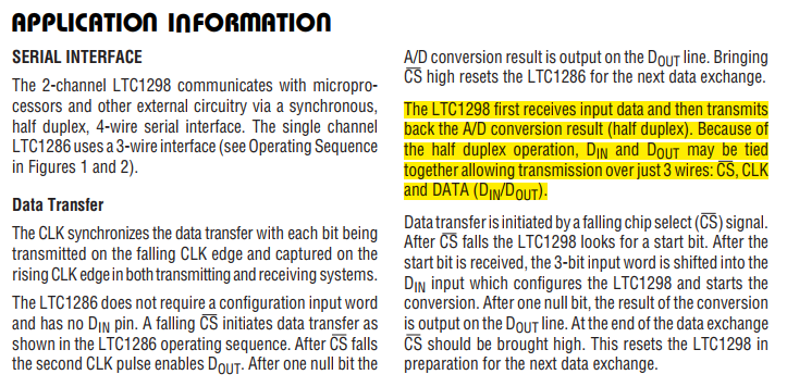

I'm currently working on establishing communication with an external ADC - the LTC1298. According to its datasheet, it uses SPI communication to initiate conversions and transfer its readings. Communication with the LTC1298 is half-duplex. As it is my first time working with the SSI modules in TivaWare, and SSI in general, I have a couple questions:
  • According to the LTC1298 datasheet:
    "The CLK synchronizes the data transfer with each bit being
    transmitted on the falling CLK edge and captured on the
    rising CLK edge in both transmitting and receiving systems."
    From my understanding (and according to section 15.3.4.6 of the microcontroller datasheet), this corresponds to the following frame format: SSI_FRF_MOTO_MODE_3 (Polarity = 1, Phase = 1)?
  • The sampling rate of the ADC is 11.1 ksps, and the maximum SPI clock rate it 200kHz. What clock rate would you recommend in this case? Would 150kHz sufficiently account for the sampling frequency?
  • "The data transfer is initiated by a falling chip select signal" - I understand that this part is handled by the TivaWare library upon calling SSIDataPut()? And that chip select returns to its original state after the message is sent?

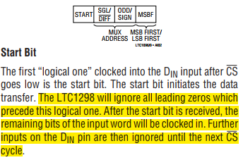

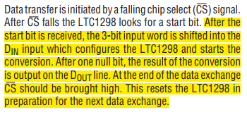

  • According to the datasheet, the LTC1298 requires the following input data to start the conversion:
"After CS falls the LTC1298 looks for a start bit. After the
start bit is received, the 3-bit input word is shifted into the
DIN input which configures the LTC1298 and starts the
conversion. After one null bit, the result of the conversion
is output on the DOUT line."
  • The conversion is output after one null bit, does that mean I should wait for at least 1 clock cycle before attempting to read the data in the receive FIFO, or does SSIBusy() handle this? Perhaps I should use SSI interrupts instead?
  • I understand that I need to send this message manually to initiate the transaction, using SSIDataPut(). Will my message be sent MSB first, or do I need to reverse it? The last field in the message (MSBF) determines how the data is returned to the Master (MSB first or LSB first) - which option should I choose in this case - i'm assuming MSBF.

    • You wrote, "Communication with the LTC1298 is half-duplex" - yet - does not SPI (but) for one 'special mode' - almost always employ 'Full-Duplex?'   (i.e. Data is 'Written & Read' upon EACH SPI Clock Edge - usually different edges for each.)    From where did you determine 'Half-Duplex' as the operating mode?
    • As 'follow' to the above point - your first 'bullet' suggests that 'Full-Duplex' is employed!    "each bit being transmitted on the falling CLK edge and captured on the rising CLK edge"

    You (or the ADC manual) noted,  "After CS falls the LTC1298 looks for a start bit.   After the start bit is received, the 3-bit input word is shifted into the DIN input which configures the LTC1298 and starts the conversion.    After one null bit, the result of the conversion is output on the DOUT line."
    While your inclusion of this writing was 'vital' - what's really needed is a, 'Timing Chart.'
    And the 'plot further thickens' - you've chosen 12 bit SPI data width - yet the (above) requirement demands:

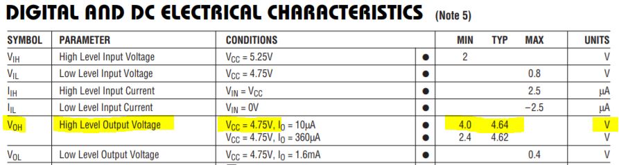

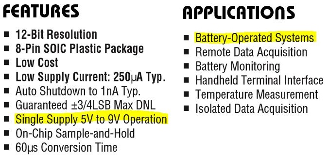

    It should be (first) noted that the 'Device Chosen' is spec'ed as 5V-9V powered - thus 'Not really Proper' for use w/3V3 powered MCUs!    There exists another (near identical device) 'LTC1288' - which is (properly 3V3 powered!)    Following are 'key extracts from the LTC1298's data sheet.'    (this illustrates the poster's (admitted) inexperience w/such SPI devices - and why I advised against its use - at this time.)
    Thru good fortune alone 'VIH' proves acceptable.    (usually a 5V powered device seeks beyond 3V5 as its VIH.)    However - 'VOH' exceeds the input capacity of the MCU!    That can be cured - yet the ADC Vendor recommends the (more proper) 'LTC1288' - a 3V3 powered ADC - instead!     That recommendation deserves compliance - and (greater) Attention to Detail...
    Further 'proof & support' of the above is offered w/in the Notes portion of a quickly following spec:    (Yet somehow - 2 here 'missed' this!)
    And - We are about to enter a 'RED FLAG ZONE!'     (Frame's '12 Bit Length' is challenged (Kicked properly to the curb - ideally) as well!)
    As my initial post here well noted - poster's election of a, '12 bit SPI Frame' - cannot accommodate the 'required number of bits!'   (shown in highlight) above.

    Regarding the VOH spec on the ADC, for TM4C123GH6PM which has been highlighted here can handle the 5V VOH except for PD4, PD5, PB0 and PB1, which are limited to 3.6 V. Section 24.13.1 GPIO Module Characteristics outlines this in more detail, and the one caveat would be exposing the device to a prolonged period of 5V when VDD is not applied, but I don't believe this ADC would subject the device to such a behavior when powered down.
    While that's true - the ADC Vendor clearly recommended (In Writing!) the use of a 'Far more suitable' 3V3 powered, equivalent device!    That clearly would have been a Superior Choice!

    And - demanding 'restatement' - my earlier identification of a, 'FAR SAFER (3V3) ADC' - noted as such by the ADC Vendor' - eliminates (any) such 'VOH' issue...
    And STILL - there exists  DAMAGE to the claim of, 'Not factually Correct!'
    Our poster NEVER stated that he would run the ADC from (only) a 5V Supply!   Note that  the ADC's 'Page 1 Data' reveals, the supply is 'MINIMUM of 5V - ranging to 9V!'
    As the below well notes - this ADC is (often) employed for Battery Use - a 9V Battery proves a, 'Most Usual Suspect' - and the increased VOH will then (surely) 'KILL YOUR MCU!'
    My CAUTION in regards to VOH thus (continues) as 'Well & Safely Advised!'     There (may) exist 'factual uncertainty' - but NOT 'incorrectness.'   (We called ADI - and they too were 'uncertain.')
    Being guaranteed 'SAFE' always trumps 'SORRY'  (especially when Safe arrives thru 'luck' only!)  - you surely agree...

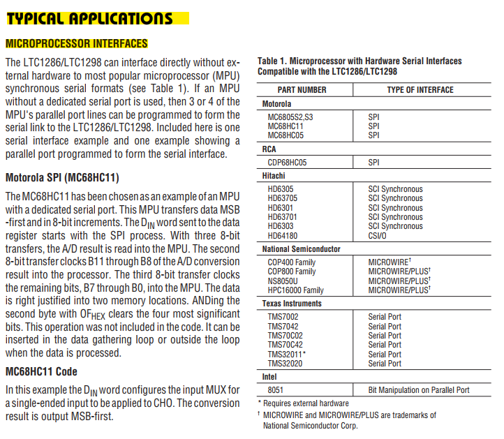

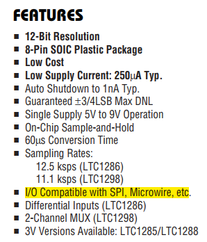

    The device features specify that the ADC I/O is compatible with "SPI, Microwire, etc.":
    Also, examples of interfacing with various MCUs using SPI, microwire or serial interfaces are provided at the end of the datasheet:
    Hence my assumption that establishing SPI communication between the TM4C123GH6PM and LTC1298 should be relatively straightforward - given the right configuration and parameters. However, after looking through the examples, I wasn't exactly sure as to which method I should refer to (each one is different). Regarding your concern of the half-duplex nature of the communication, that's described (briefly) in the datasheet:

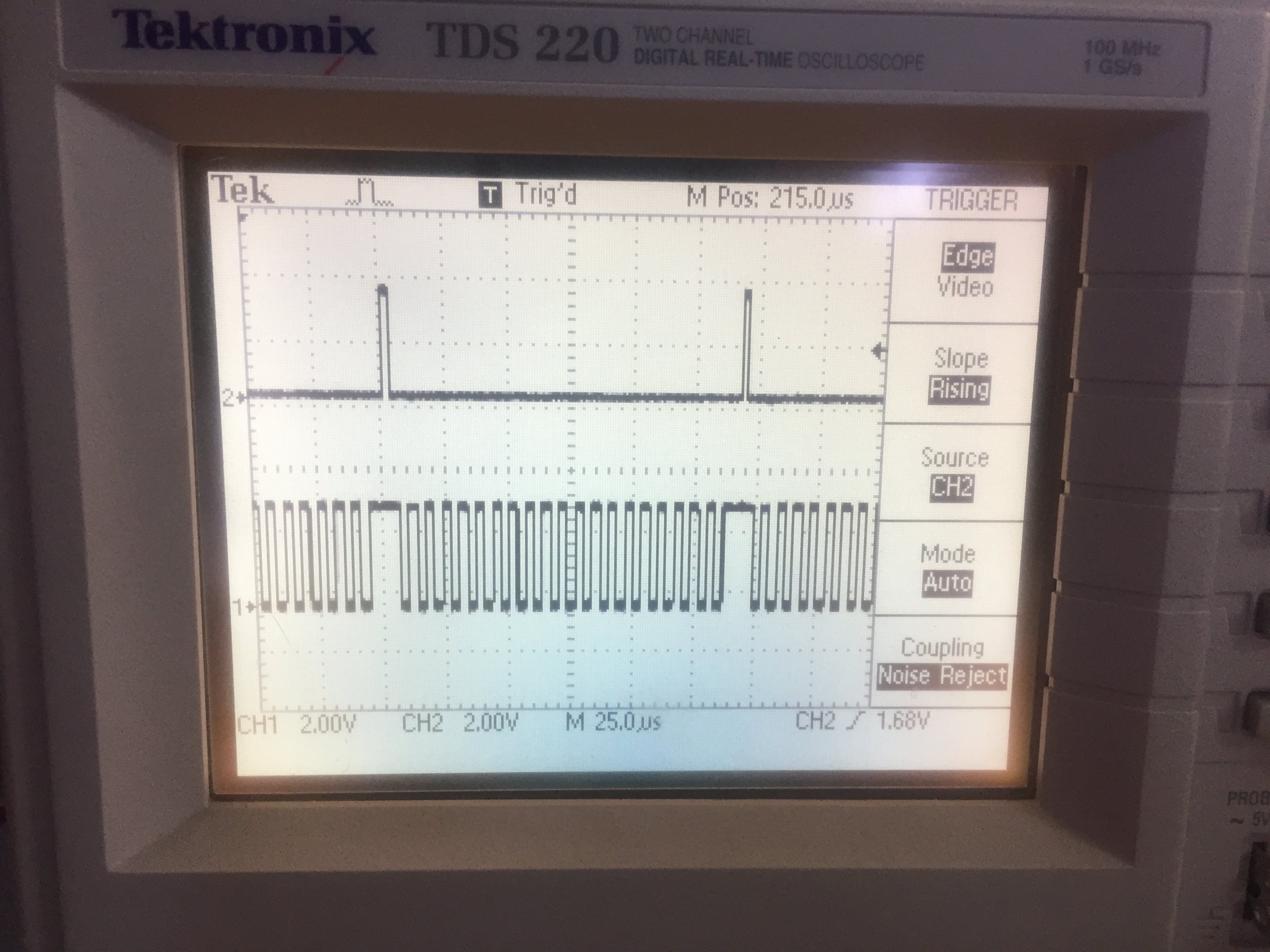

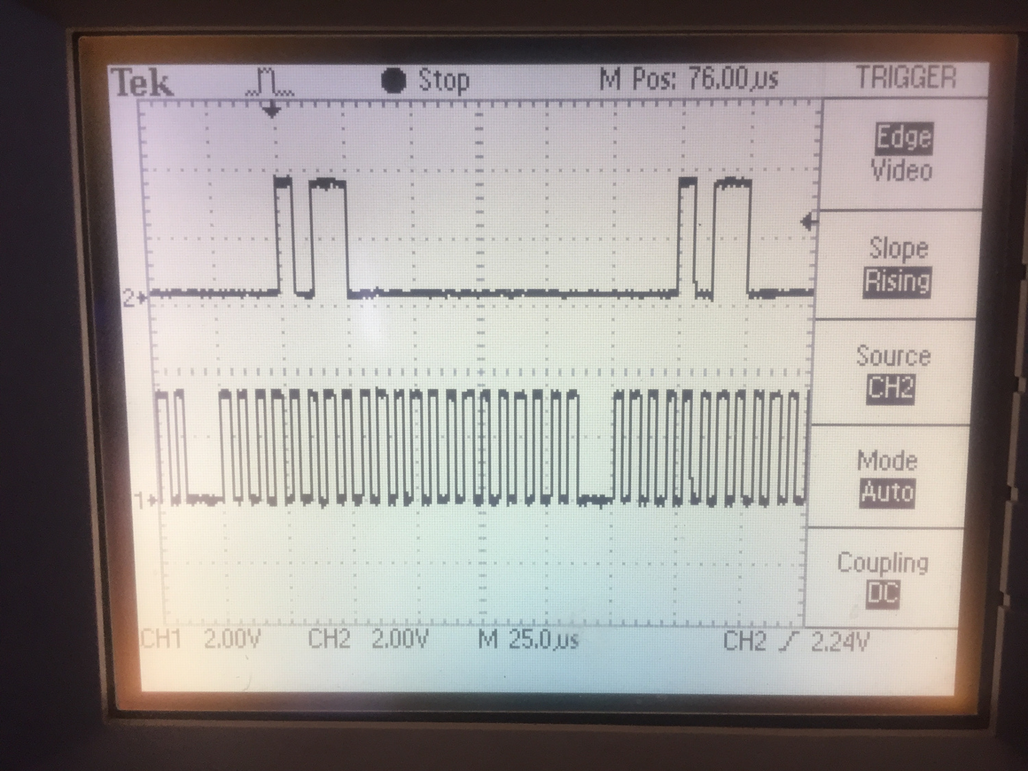

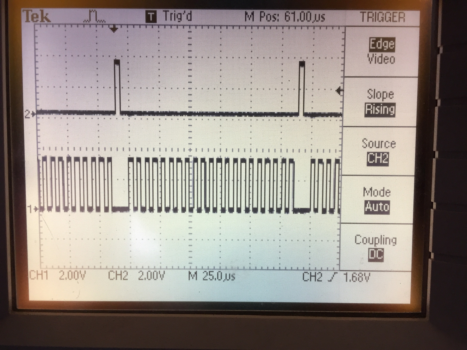

    Here is the clock and FSS signal output from my scope - only 4 clocks are generated for FFS low, for some reason.
    Curiously, when I switch to SSI_FRF_MOTO_MODE_3, I get the following outputs:

  • Hi Ralph.
    Thank you again for your help.
    As per your recommendation, I implemented the following:
    while(1)
        SSIDataPut(SSI1_BASE, 0xD); //send 4-bit instruction
        SSIDataGet(SSI1_BASE, &ulSPIReading); //read bits 12-10 (1st bit is null)
        SSIDataGet(SSI1_BASE, &ulSPIReading); //read bits 9-6
        SSIDataGet(SSI1_BASE, &ulSPIReading); //read bits 5-2
        SSIDataGet(SSI1_BASE, &ulSPIReading); //read bit 1
        SSIAdvDataPutFrameEnd(SSI1_BASE, 0);
    I plan to put the data in the right place once I get the application working, just using the ulSPIReading variable repeatedly for testing purposes.
    I also updated the advanced SSI configuration to SSI_ADV_MODE_READ_WRITE, instead of SSI_ADV_MODE_WRITE, since i'm both writing to and reading from the slave.
    Unfortunately, the whole application hangs on the 3rd call to SSIDataGet(). The ADC is currently not connected, but I guess that shouldn't stop the SSI functions from working - even if the Rx FIFO is empty?
    Ksawery
  • Ok, after doing some more research, I believe I finally found what I was looking for, in the TM4C123G Datasheet:
    Unlike the full-duplex transmission of the other two frame formats, the MICROWIRE format uses a special master-slave messaging technique which operates at half-duplex. In this mode, when a frame begins, an 8-bit control message is transmitted to the off-chip slave. During this transmit, no incoming data is received by the SSI. After the message has been sent, the off-chip slave decodes it and, after waiting one serial clock after the last bit of the 8-bit control message has been sent, responds with the requested data. The returned data can be 4 to 16 bits in length, making the total frame length anywhere from 13 to 25 bits.
    What the LTC1298 ADC is actually using, is the MICROWIRE SSI format. As described in the LTC1298 datasheet, the communication is half duplex, and the device expects an initial 4-bit instruction message. After decoding the message, and clocking in one null bit, it sends a reply that is 12 bits in length. Data is clocked in on the rising edges of the clock, and FSS is held low during the entire transaction. The clock is held low and FSS is held high in the idle state. This corresponds exactly to the MICROWIRE format, although it wasn't explicitly stated as such in the LTC1298 datasheet (only briefly at the beginning). For a person that is unfamiliar with this format (such as myself), this can be a bit confusing.
    I used the following SSI configuration (with all advanced modes now disabled):
    SSIConfigSetExpClk(SSI1_BASE, SysCtlClockGet(), SSI_FRF_NMW, SSI_MODE_MASTER, 150000, 12);
    And the following code to read/write data:
    while(1)
        ... //remainder of application
        SSIDataPut(SSI1_BASE, 0x0B); //send instruction
        while (SSIBusy(SSI1_BASE)) {}
        SSIDataGet(SSI1_BASE, &ulSPIReading); //read data
        usRegInputBuf[0] = (USHORT) ulSPIReading;
    The CLK and FSS outputs on my scope are now as follows:
    These outputs, I believe, are now correct. There are 21 clock signals during the time that FSS is held low. I'm assuming, that these correspond to the initial 8-bit instruction (the first 4 zeros of the 8-bit instruction will be ignored by the LTC1298), followed by 1 null bit, followed by 12 data bits read from the device = 21 in total.
    The circuit should be completed by tomorrow, so I should be able to test the application then, but for now i'm optimistic with the result.
    EDIT: the initial instruction (0x0B) is sent at the expected time - 4 zeros followed by the 4-bit input word (top trace = SSI Tx channel):
    Ksawery

  • You are to be applauded for persistence.     While the method shown 'appears to succeed' - might weaknesses (still) lurk?    And - might an (even) more efficient method exist?
    Our Tech Group employs (only) the TM4C123 series from this vendor - thus your chosen, 'SSI_FRF_NMW' is unavailable to the many, '123 users!     The more normal & available, 'Microwire Frame Format' (SSI_FRF_TI)  IS available however - and appears (also) to succeed!
    With that noted - it  appears likely that an (even more inventive) method - employing  'Just 16 clocks' (down from poster's 21) - has a strong 'likelihood of success' - and  FAR Better (i.e. Alone) 'Recognizes & Exploits'  ADC Performance Reality!
    As my far earlier post noted - the device's timing chart reveals that '17 clocks' are required to perform a complete & proper, 'Device Command & Data Reception.'    How then - can 'Just 16 clocks' work?    This is where 'Design Experience' - which, 'Exposes Circuit Implementation (i.e. Real World) REALITY' - enters the picture!    It is (almost) certain that the 17th clock - which captures the 'Least Significant Bit' of the ADC's Data Stream - will present that last bit, 'JITTER-RICH!'   Thus  w/out any REAL Value!     (And likely 'flawed too' - the adjacent bit!')    And thus we (quite properly)  'Cast (Noise Plagued) 'bit 17' to the curb!'
