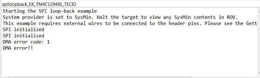

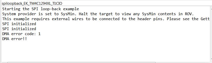

I am trying to execute the example code for TM4C1294NCPDT SPI code. But while executing it shows DMA error.
It will be so helpful if you can help out to solve this.
I am using "spiloopback_EK_TM4C1294XL_TI" example project from resource explorer

  • Srinivasan,
    The output shown above does not match the spiloopback example.  The first two lines do, the beginning of the third seems to be truncated, and the next three don’t match the output from any TI-RTOS example.
    Have you built and run the unmodified spiloopback example?  If that doesn’t work, what output do you get?

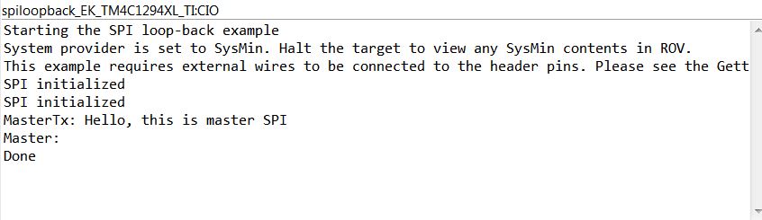

  • Hey Scott,
    Thanks for the reply.
    When I run the unmodified code its working.

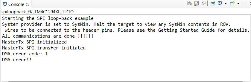

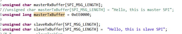

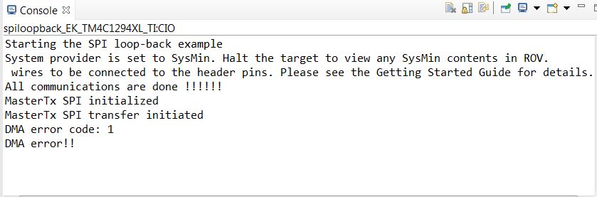

    Actually i only one change. I changed the data from unsinged char array to unsigned long. If i change to unsigned long it shows error
    Error:

  • Srinivasan,
    By changing masterTxBuffer from an array to an unsigned long, you are essentially defining a pointer, and “0xEE0000” is not a valid memory address.
    In masterTaskFxn() this address of 0xEE0000 is placed into a SPI_Transaction structure and passed to SPI_transfer():
        /* Initialize master SPI transaction structure */
        masterTransaction.count = SPI_MSG_LENGTH;
        masterTransaction.txBuf = (Ptr)masterTxBuffer;
        masterTransaction.rxBuf = (Ptr)masterRxBuffer;
        /* Initiate SPI transfer */
        transferOK = SPI_transfer(masterSpi, &masterTransaction);
    The result is a DMA error due to the bad buffer address.

  • Hey Scott,
    Thanks for the reply. I understood the fact of changing the datatype from array to unsigned long, but "0xEE0000" is not an address. It's the data I want to send via SPI to another device.
    If changing the datatype is the issue, how do i solve that ?
    Srinivasan.
  • masterTxBuffer is an array (buffer) of characters that are to be transferred.  This buffer address is specified in the SPI_Transaction structure that is passed to SPI_transfer(), as shown in the above snippet.  If you want to change the characters that are sent this example, you should change the contents of the character array, to the sequence of bytes to be sent.  You should also change the transfer count for the number of characters to be sent, in other words set the proper ‘masterTransaction.count’ in the SPI_Transaction structure.
