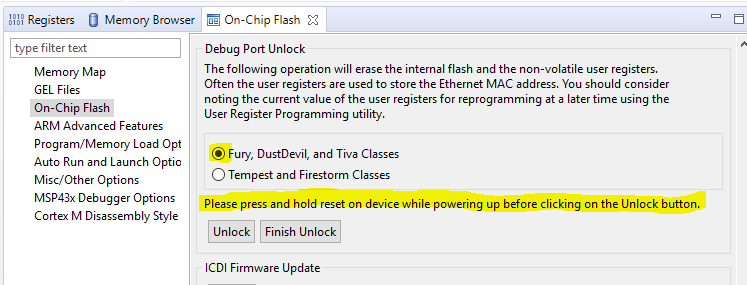

  • If the device in in Hibernate mode, it cannot communicate with the debugger so it cannot be reprogrammed. The application should have some way of coming out of hibernation mode, or prevent it from going into hibernation mode, such as the level on a port pin. If you have a part that is stuck in hibernation mode, the solution is to use the Unlock procedure to  erase the entire flash (including user registers and MAC address). There is the option to do this in CCS, but if using the Stellaris ICDI (such as is on the launchpads) it is not currently working. Use LM Flash Programmer instead. Once the flash is erased, you can go back to using CCS.

    Could you point me where we can find Unlock procedure in CCS?

  • Launch the target configuration for the TM4C129 device, but do not power-on the device yet. From the menu select "Tools" -> "On-Chip Flash".  Scroll down in the On-Chip flash dialog box until you see "Debug Port Unlock" as shown below. Select the Tiva Class devices. They must hold reset while the device is powered on and click the unlock button before releasing reset. Follow the instructions given. I have not tried this with XDS110.
