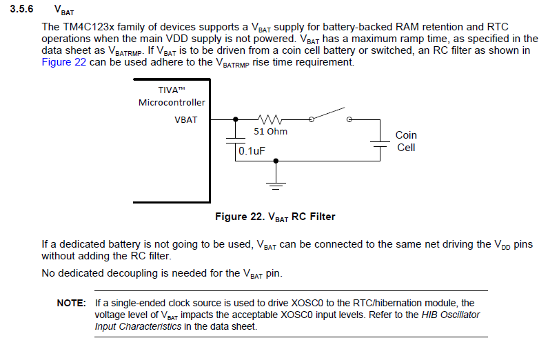

I need to know if the internal circuit of Vbat has protection for inverse current, i.e., in case of a failure, how much current can be drained from the VBat pin.
Thank you.
  • What type of failure mode are you considering? Section 3.5.6 of the System Design Guidelines for TM4C123x Family shows using a 51 Ohm resistor with a coin cell battery primarily to control the rise time, but it also will limit the maximum current flow.

    Alien (outsider) responding - Fig. 22 (post above) provides (some) current limiting via the 51Ω series resistor.
    Your stated concern - 'Inverse Current' (i.e. Current sourced by the MCU's 'VBAT pin') appears (to an outsider) as unlikely.
    Yet - while that  'may hold true' under, 'Normal MCU behavior' - under MCU's,  'distress or failure conditions' - inverse current (may then) flow!    And - as the battery, 'Ages & Discharges' the 'vulnerability to such Inverse Current increases!'     (Much to the Battery's detriment - which IEC61010-1 seeks to mitigate.)
    Now - even if there exists (some) 'Directional Current Flow Mechanism' w/in the MCU - that itself is, 'Subject to Failure' - is that not true?
    More positive protection (i.e. Inverse Current Resolving & Regulatory Agency favoring) is afforded by a,'Low Voltage Drop, adequately rated, Schottky Diode' - placed (externally) in series w/the resistor.  (per the above post)   (Diode's anode tied to the Battery's (+) terminal.)    In such case - the values of the R-C Network may have to be 'tweaked.')
    Optionally - if (even) a (further) reduced voltage drop (than that offered via the diode) is sought - a 'Small Signal P-FET' may present, 'Even lower impedance - yet maintain the SAFE, 'One Way ONLY' current flow path' - between Battery & MCU...

  • I think CB1 did an excellent job answering your question, but in case you want a "vender" to answer it, the TM4C123GH6PM is designed such that it does not source a current out of the Vbat pin even when Vdd is greater than Vbat. However, I cannot interpret IEC 61010-1 for you. If they mean protected by any failure in the microcontroller, then that would imply protection against a failure in the internal circuit that prevents the inverse current. If that is the intent of the requirement, it would preclude the internal circuits from meeting this requirement. You should discuss this with your company safety assessor.
