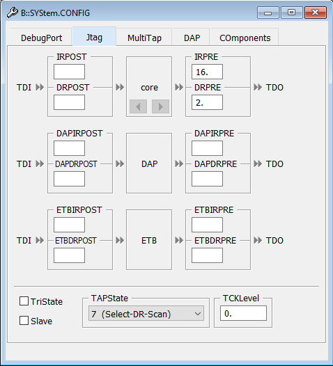

The figure below is the design of the JTAG daisy chain that I'm using .
The TMS570LC43 is chained with two FPGAs ( IGLOO2) and I'm using TRACE32 from Lauterbach as a debugger.
When I try to detect the daisy chain with the debugger I got the following information :
In the debugger I can configure the following parameters :
But I'm not sure about what numbers write and where. Do you know what should I write ? Also, should I configure the IcePick-C module or is it done automatically ?
Thank you for your help.
