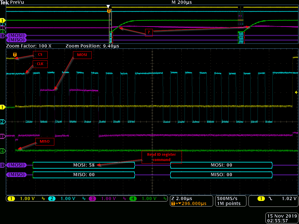

Dear Sirs
I'm using the EK-TM4C1294XL LaunchPad to talk to a ADI ADT7311 temperature sensor by way of the SPI bus.  I have CS, CLK and MOSI signals, but no MISO signa.  I've tried SSI0 through SSI2 with the same results.  Please see attached scope screen print.  Any help will be appreciated.  Please note the MISO signal rise.  I'm sure this is not right.

    From your scope cap (we may have that same Tek Scope - btw) It is suspected that:
    • your chosen 'MISO' pin was incorrect or otherwise improper  (i.e. not fully/properly configured)
    • or there may be an 'issue' w/the ADC device and/or its configuration    (my group happens to consult for ADI)
    • there does appear to be an, 'Unholy linkage' between the SPI 'CS & MISO!'     Close review reveals that 'MISO' (Dives near ground - exactly as 'CS' makes that 'same transition!'    My team does not believe that represents, 'Normal/Customary SPI signal behavior!'
    • in light of the above - do INSURE that the ADI device is properly powered (especially when active) and that the ground attachment between your ADI (board, hopefully) and your MCU is robust...  (and present)
    What to do?    We suggest (temporarily):
    • Breaking the connection (only!) between your MCU's 'MISO' pin and ADI's device.   All other pins remain inter-connected!
    • then attaching your scope probe to the ADI's 'Slave Output Line' (same one which originally attached to MCU's MISO pin - now 'going nowhere')
    • and then, 'Noting How & If' the ADI device's output waveform changes  -  this will assist our determination of 'which' device is (most likely) faulting.
    As always - 'Full & Proper Data' ... 'Speeds, Eases & Enhances' our (and others') Remote Diagnostic Capabilities.    Vendor will surely, (and properly) Request your code - so that 'obvious code errors' may be 'Recognized & Corrected.'
    Your scope capture IS Helpful - yet by itself - proves less than 'fully aiding/enabling & conclusive...'

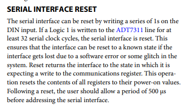

  • I am not concerned about the slow rise time on MISO (Master in Slave out) after CS (chip select) goes high. While I am no expert on the Analog Devices ADC, it does say in their datasheet that when CS is high the device is disabled. It does not surprise me that the DOUT pin of the ADT7311 would go high impedance when CS is high.
    I don't see anything wrong with the SPI signals coming from the TM4C. I agree with CB1 that you should double check the hardware interface with the ADT7311. The only other suggestion is that you might try the serial interface reset procedure described on page 19 of the ADT7311 datasheet.
    You can do this by sending four bytes of 0xFF out the SPI. Remember to then wait at least 500uS before sending the 0x58 command to read the ID register.
  • Dear Mr. Crosby
    I'm sorry for the late response.  I just wanted to make sure that all was working correctly.  I took your advice and added the software reset to my startup routine.  I've learned my lesson, never rely on power up default conditions.  Thank you for your help.  You can close this service request.
