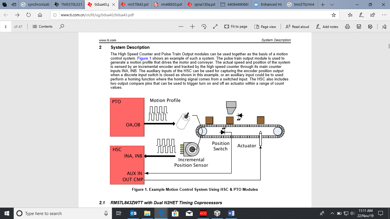

Hi
1>can we implement below example(motion control system) in rm46L852 ?
2>is there any HSC(high speed counter) and PTO(pulse train output) module present in rm46L852?
i did not get same module in rm57L843 datasheet
please guide me. thanks
2>for 2nd question
    HSC and PTO in this TI design are both based on N2HET timer ( HSC and PTO are hot hardware modules ). RM46L852 has two instances of N2HET module ( N2HET1 and N2HET2 ) and they can be used for implementing  HSC and PTO.
    The second picture in your post is part of TIDUA43.pdf, Section "3.1 N2HET Based High Speed Counter" where this is explained.
    Detiled description of N2HET module can be found in TRM of corresponding MCU.
