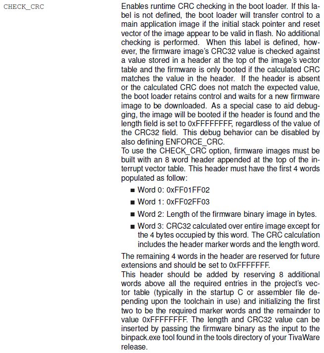

      The ROM bootloader will first check if there is a valid stack pointer and the reset vector at 0x0 and 0x4. If these two locations contain non-F values, then the bootloader thinks that there is already an application present. It will just jump to the application. However, your bootloader process didn't complete successfully due to the power loss, the application program image is only partially programmed. You are left in a state where the application does not run and the bootloader does not start since it thinks the application is already there. I don't really see a solution for this.
      I will suggest you try the flash-based bootloader instead. In the flash-based bootloader you can enable runtime CRC checking. Please see below excerpt or go to the TivaWare bootloader user's guide for detail.

    Anyways, I still second the idea of using the Flash Boot Loader but wanted to mention this other option.
