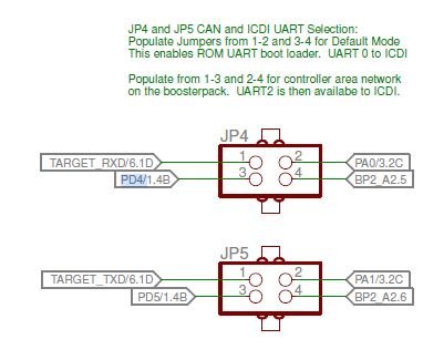

      What is your JP4 and JP5 settings? Since you said all other pins are fine except the PD4 and PD5, I look at the board schematic to see anything significant about them. The only thing I see is the below? However, I can't explain why it would make a difference compared to other pins. I have the two jumpers in the default 'horizontal' position.

    Charles,
    I had the jumpers in the horizontal position. I then removed them entirely and the problem persists.
    Also, I cannot say for a fact that ALL other pins are fine. I have only tried PD4, PD5 and PJ0, PJ1, PP0 and PE4.

  • Chester,
    Yes, thank you for this analysis. I was using CSS v7.2 for this work. I will update to the latest version.
    Thank you, svl123.
