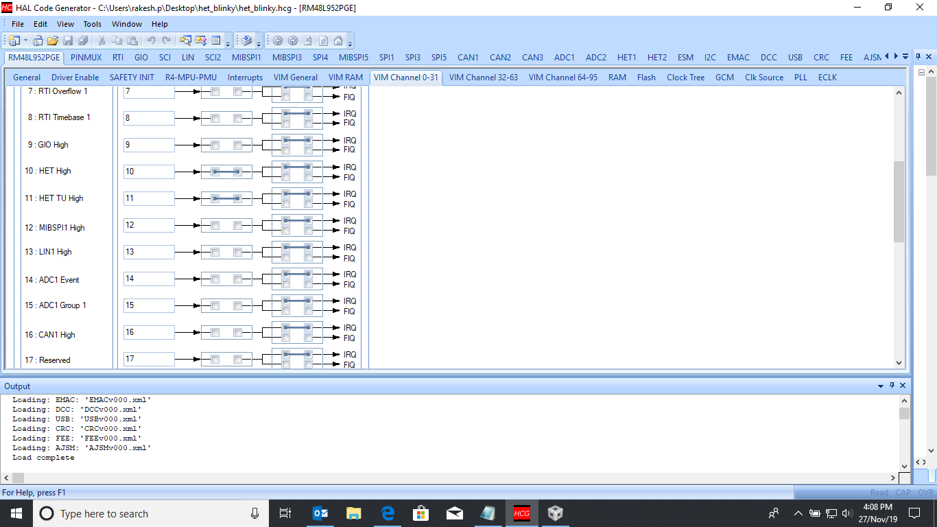

Part Number: RM46L850
Hi
may I know the use case of following sshot.(I m following an example program)
11 and 25
Hi
11 and 25
VIM Interrupt Channel 11 is assigned to HET Transfer Unit Level 0 ( high priority ) interrupt and Channel 25 is assigned to HET Transfer Unit Level 1 ( low priority ).
HET Transfer Unit is described in TRM, Section 24.
VIM channel assignment can be find in Datasheet, Table 6-32.
