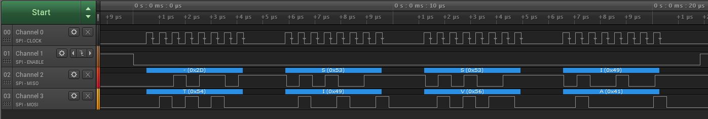

I use SSI interface as SPI slave port. If the master sends words with a chip select pulse for each serial word the reception of every word is ok. But if I try to send a lot of words with one chip select pulse I get a failure: the receiver accepts only one (first?) word from each frame. Words have bit depth as 16 bits. Here are some source codes with my initialization. Could anyone suggest how to receive every word form the multy-word frame with one common chip select pulse?

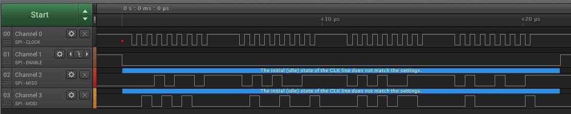

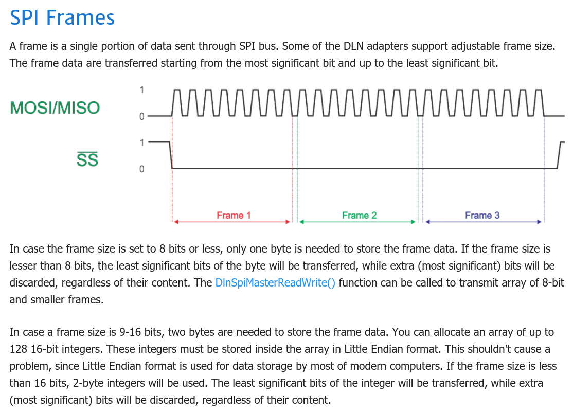

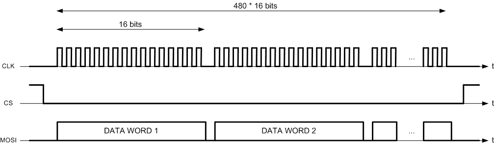

  • It seems there was a misunderstanding in terminology. So what I meant in my question:
    1) The problem is ONLY for the slave device - the master one is out of my control.
    2) WORD - it's the 16-bits packet over SPI with clocks and data, there is no mention of CS state
    3) FRAME - it's the time period when CS pin is in an active state (in my case it's a low state)
    Also I attached some diagrams that may explain the situation.

    I believe your timing diagram indeed proves helpful - and the 'difference between vendor's belief - and my own - revolves around the definition of, "continuous back-to-back."    My belief is that 'Your Drawing' (post above) clearly illustrates/demonstrates that, "continuous back-to-back" data transfer.

      As to the OP's original question, MODE_0 will not work as noted in the datasheet. Since the MCU has this limitation, the OP will need to find alternative solutions outside of the MCU. Both you and I have already asked what type of device is this external master and if it is possible to configure the master to operate in a different phase/polarity that will work with the MCU. Can an external logic provide a manual chip-select to the MCU.

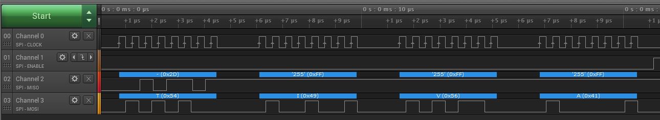

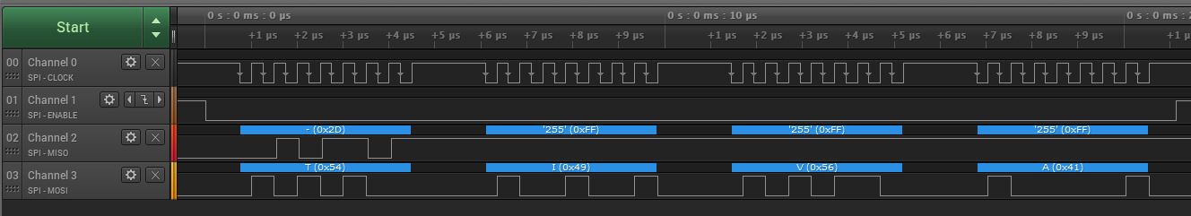

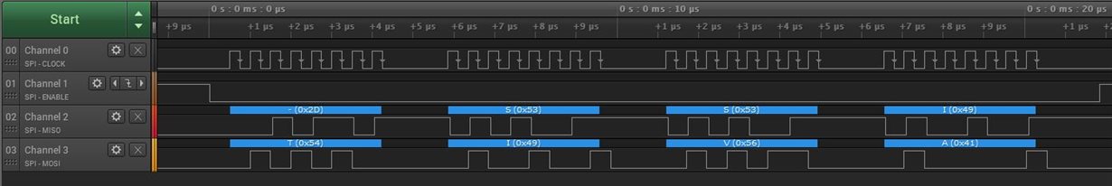

    Below are some LA captures.
    The master should send "T", "I", "V", "A"
    The slave should send "-', "S", "S", "I".
    As you can see both MODE_0 and MODE_2 with SPH=0 fail with the slave not transmitting the subsequent characters with one active chip-select.
    MODE_0
    MODE_1
    MODE_2
    MODE_3
