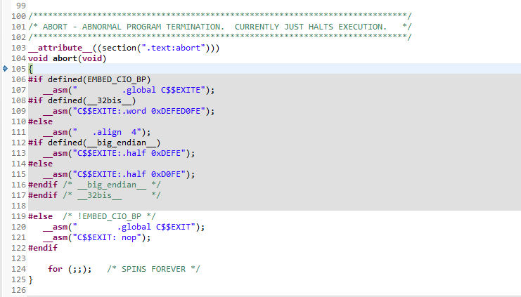

hello everyone i successfully implemented I2C (master_slave_loopback) example
but after running the code and get the data
the project paused and go to exit.c file
whats the purpose of this ??
  • If your main function does not have an infinite loop, when the the main function completes the CPU goes to exit. It just means your program completed and there was nothing left to do. Most true real time control programs have an infinite loop so they never get to exit.

    I saw the same exit too in another example. Yet had expected the CPU instruction pointer to start over at flash address 0x0 when the stack pointer rolls to 0x0 and not exit.c as it did. Seemingly this is an ARM Cortex behavior?
    "while(1){} what" was the question in my mind, main.c=(1)?
