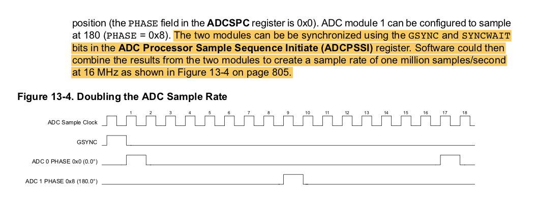

    I now use a single-sample sequence and trigger the DMA to make 1024 transfers with arbitration size of 1 (this should mean that the ADC is triggered by a timer at the desired frequency, the sequencer converts one measure, the DMA is triggered after every sample and the interrupt routine is called when all of the transfers are completed). However, when I stop the debugger in the ISR, the overflow status of the ADC FIFO it is overflown unless the timer counts more than 165 cycles. Since the CPU is running @80Mhz, 165 cycles means 32+1 16Mhz cycles. This would seem to imply that the ADC is actually generating 500Ksps (and then uses one more cycle to trigger the DMA transfer, maybe?) and I hit a limit if I try to push it faster than this.
    To achieve 1Msps I had to activate the second ADC phase-shifted of 180° and in this case I can double the rate. This seems in line with what stated in the DS. However, from the picture in the same page it would seem like a single conversion would take 16 cycles, so in theory the two ADC working together could sample every 8 cycles, meaning 2Msps. I find this section (13.3.2.5) of the datasheet a bit counter-intuitive, can you help me clarify it?
