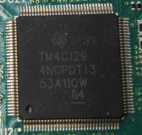

Top mark on the device is as follows:

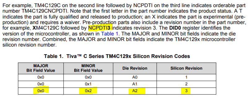

Decoding the register contents using the table from page 255 of the datasheet (http://www.ti.com/lit/ds/symlink/tm4c1294kcpdt.pdf) yields:
  • Good Device = 0x100A0002
    • Silicon Revision = A2
  • Bad Device = 0x100A0006
    • Silicon Revision = A6
Per the errata (link below), the "I3" on the top marking indicates silicon revision "A2"

    I agree that the markings definitely indicate A2 die revision which is silicon revision 3, and that is what I would expect the device to report back. Not sure what could cause a wrong register read for DID0 but something seems wrong with that.

  • Hi Don,
    Your post states TM4C1294KCPDT yet the picture is NCPDT. Perhaps the project has not selected the correct tool set? The CCS debug GEL file memory map differs KCPDT versus NCPDT.
