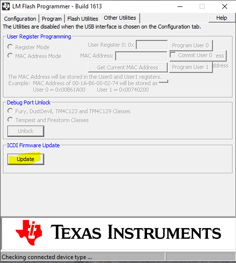

We have developed a custom board that uses the majority of the design on the EK-TM4C1294XL eval board, and we need to program the debugger chip (TM4C123GH6PM) so the main chip (TM4C1294NCPDTI3R) can be programmed through the USB port.  I haven't been able to find a binary for this chip.  Any help finding this?
Angelo

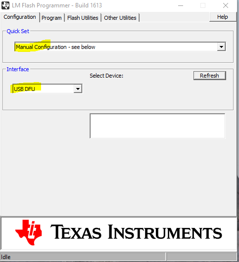

  • If the TM4C123GH6PM is still blank, you can use LM Flash Programmer to program the Stellaris ICDI firmware. Configure LM Flash Programmer to Manual Configuration and then select USB DFU. Connect the PC to the TM4C123 USB connector.
    Then on the "Other Utilities" tab select the ICDI Firmware "Update" button. It will give you a warning that the device is not a an ICDI (because it does not have an existing version of the firmware in it).  It will ask if you want to rewrite and update this device. Select "Yes".

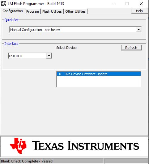

  • Thanks for your support Ralph and quick response.  If I connect the eval board through the TM4C1294 chip USB port and change the power jumper, I don't see any device appear in LM Flash programmer.  This is even after erasing the chip through the ICDI interface (which does work).
    On the custom board, when connecting to that USB port, a device appears in LM FP, called "Tiva Device Firmware Update".  If I try to program a bin file I get "An error occurred during USB download!".  If I try to erase the chip I get Error -3: DFU_ERR_NOT_FOUND. Blank check gives Error -4: DFU_ERR_UNKNOWN.
    Since this chip also had the UBS port changed from micro to USB-C, I'm concerned the absence of the ID pin may be the cause.  Is the chip in host or peripheral mode when in DFU?  Should I ground the ID pin connection (PB0)?
  • Thinking about it some more, that ROM bootloader may not help much if it only works on blank chips.  We would still be left with a board that can't be updated via USB without the ICDI chip on-board.  Is that correct that once there is something loaded in the TM4C Flash that the USB ROM bootloader can't be invoked again?
  • Hello AQ,
    For the LaunchPad
    Did the blank check clear? How are you looking for the device in LM Flash? Do you see a Tiva Device Firmware Upgrade device in your Control Panel -> Device Manager?

  • For the launchpad:  Yes that's what I get, and in the Device Manager I see "Stellaris Device Firmware Upgrade", but I can't load a binary after that.
