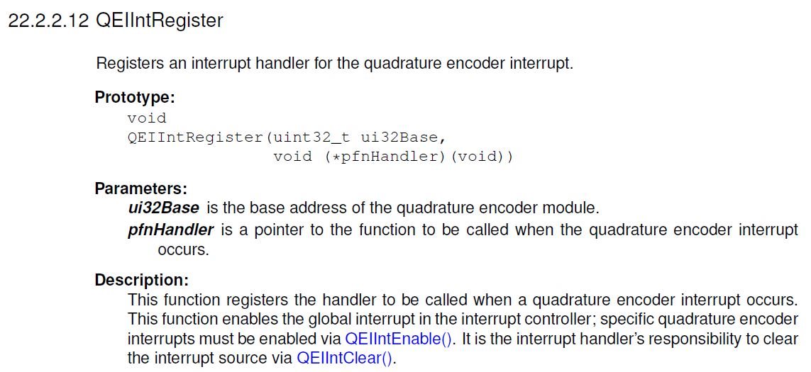

    If you want to register an QEI interrupt you should be calling QEIIntRegister(),

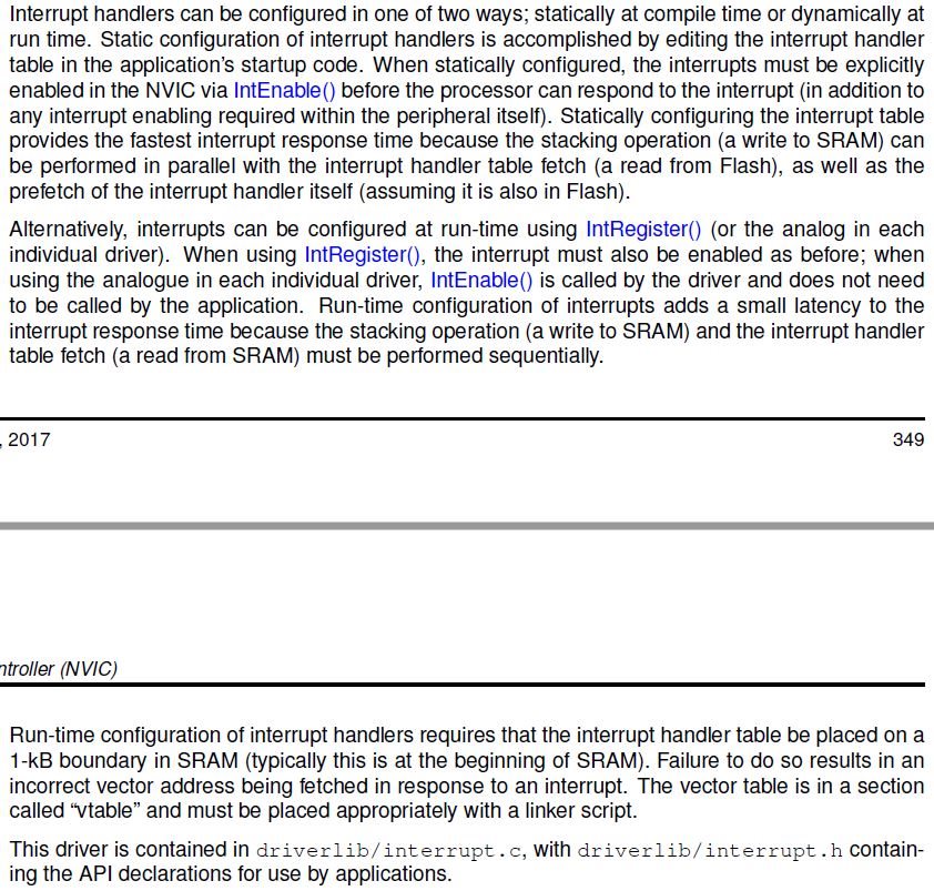

    I'm not too sure why you are getting a compile error. Instead of doing the dynamic registering of the interrupt I will suggest you assign the interrupt vector statically to see if resolves the issue. You will update the startup_ccs.c file like below. You can reference some of the TivaWare examples such as <TivaWare_Installation>/examples/boards/ek-tm4c1294xl/interrupts to get an idea how the interrupts are configured.
    Please also note the difference between static and dynamic configuration of the interrupt. Below is the excerpt. You can find the details in the peripheral driver library user's guide.

  • Thanks Charles for the explanation of interrupts. It’s going to take me a while to get to grips with it. I obviously would want a static configuration as the encoder will be changing position at a relatively high angular frequency.
