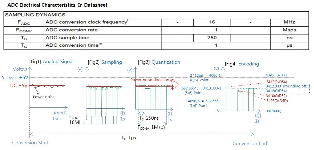

    Q6> Is the symbol (FADC, FCONV, TS, TC) correct indicated in the illustrated Figs. ?
    Q7> Is the sampling frequency (1 / TS) 1 / 250ns = 4Mhz?
    Yes,
    No, typically we refer to the sampling frequency as how often you sample, not the inverse of the sample time. In your example the sample frequency would be 1M sample/second (1Msps or 1Mhz).
    Jame shin said:
    Q8> What is the difference between FADC = 16Mhz and Sampling Frequency (1 / TS) = 4MHz?
    FADC is the frequency at which the ADC operates. Sampling frequency is how often a sample can be taken. With this 12 bit ADC the default sample time is 4 ADC clocks and then 12 ADC clocks for the conversion, one for each bit. Therefore the FADC (ADC clock) is 16 times faster than the maximum sample rate.
    In most application the sample rate is even slower. If the source is a high impedance, the sample time must be increased. If more than one channel is to be converted, the sample rate for each channel is divided among the channels converted.

  • Hello Bob,
    Thanks for the clear answer.
    The last question for this thread.
    Previous Q10 Supplemental Question.
    Tc (ADC converstion Time) = 1us and Ts (ADC Sample Time) = 250ns.
    So, (ADC converstion Time) / (ADC Sample Time) = 4.
    You explained to me. In some designs, four ADC clocks (250nS) may not be enough.
    My understanding is insufficient.
    Q12> During the ADC Conversion Time (Sampling, Quantization, Encoding) time,
             Why is it divided into 4 to collect complete analog data?
             Perhaps I do not know exactly the ADC Sample time.
    Q13> And can may you explain if 4 ADC clocks are not enough?
    The sample time is a minimum of 4 ADC clocks. That gives a minimum sample time of 250nS. It is not that the sample time needs to be divided into 4 parts, just that there is enough time for the internal sample capacitor to equalize with the external voltage. A look at the ADC converter's specifications show a maximum input resistance of 500 Ohms and input capacitance of 10pF. The goal is to allow enough sample time that the internal sample capacitor can charge all the way to within 1/2 LSb of the source voltage. Worse case is if the internal sample capacitor is at one extreme and the source voltage the other as shown in Figure 8 of the Application Note I previously referenced.
    In these examples, only two of the four scenarios adequately charged the sample capacitor in less than 250nS. The other two scenarios would require a longer sample time.
