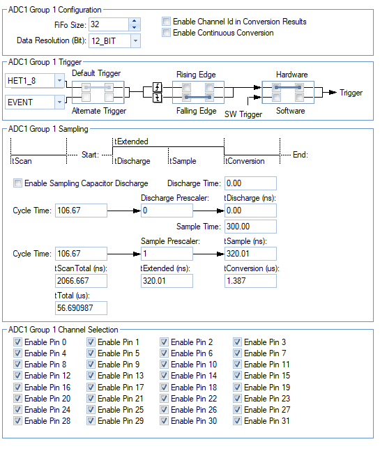

We are trying to configure our TMS570LC4357 to use the N2HET1 pin 8 to trigger A/D sampling, as per this document: http://www.ti.com/lit/an/spna227/spna227.pdf
I have set up our HALCoGen project to generate a PWM signal with a 50% duty cycle at a rate of 2000.0us (for 500Hz sampling). I have confirmed this behavior with an oscilloscope. In addition, the ADC1 Group 1 to trigger conversions on the falling edge of pin HET1_8:

    The GxINTCR[1] value is initialized to the FIFO size. The value should increment for each read (fifo mode). Before starting ADC sampling, the FIFO size (32) should be assigned to GxINTCR[1]: GxINTCR[1] = 32. This register is cleared by the NHET interrupt which triggers ADC sampling in your code.

    The GxINTCR[1] value is being initialized to the FIFO size. My application code initializes the ADC/NHET in the following order:
    adcInit()
    adcEnableNotification()
    adcStartConversion() (this is the function that initializes the GxINTCR[1] to the FIFO size)
    hetInit()
    As for SafeRTOS, it places itself in the VIM table at channel 2 (RTI Compare0 interrupt) and channel 21. This prevents our application from utilizing the RTI compare interrupt functionality - if possible, we would use the RTI notification to schedule ADC conversions, and hence why we are using the N2HET.
    James

  • Hi James,
    Yes, you can use the rising/falling edge of GIO or NHET signal to trigger the ADC conversion. The issue you got is related to safeRTOS.
