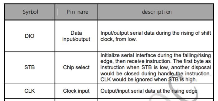

Hello cb1_mobile,
I would like to use the $3 LED&Key since I have it now but I may change my mind if it’s a failure. There are three wires on it so one must do Rx / Tx as the buttons must Tx signals back to the TM4C123GXL. Presumably the segments are illuminated sequentially given there’s only one wire effectively. And presumably it’s not noticeable on the display – or is it? But my initial quandary is - I’ve no idea which GPIO pins to map to the three signal wires. The power is obvious. I would appreciate any advice on ports and pins. Just getting the thing connected and being able to talk to it would be my first step.

The 'sequential illumination' you note is called, 'Multiplexing' - a very clever technique which reduces the number of required connections. This technique relies upon the 'Persistence of human/animal vision' - such that (usually) only one display element at a time is 'illuminating' - yet this happens so quickly that our brain perceives the 'grouped image' as, 'All on.' (if you chatter your teeth - or move your head rapidly - you can note the display scanning (i.e. only one 7 segment unit will be on at any one time) ... really that works!) More than once I've, 'Won drinks at a bar - w/that (drinkable) knowledge...'
Three signals are key:
You have two choices in MCU signal mating:
The MCU's 'SPI' capability provides a 'Clocked Serial' signalling - which (at quick glance) appears to provide 'automated' data flow - both to & from - the device's control IC. This would be my group's recommendation - provided that the MCU's SPI mode can supply the (expected) relatively large number of data & clock signals the device (likely) requires. (this last clause may prove vital to your usage...)
Note too - SPI is (usually) a 'full-duplex' (send & receive together) operation - yet this IC demands 'half-duplex' operation. This means that you must, 'Repurpose the SPI output (MOSI) pin' from output to input - to prevent 'contention' when the display IC switches from input to output. (that's not easy nor fun - thus my group would not employ this slow/awkward IC...)
Your MCU provides several SPI ports - your MCU manual reveals their location and (most - possibly all) appear on the LPad's headers.
Hookup: SPI_FSS to STB, SPI_Clk to CLK, SPI MOSI to DIO (when transmitting to device) SPI_MISO to DIO (when receiving from device ... assumed switch information) You (may) be able to tie the MCU's MISO to MOSI - so long as you, 'DISABLE the MOSI pin prior to the IC's 'Start of Transmission.' You would then receive the IC's output upon the MCU's MISO pin. (this may prove 'way too complex' for one beginning.)
Again - the 'beauty of SPI' is that the 'Serialization of Data' is automated - handled for you - via the MCU's SPI Engine. You would be charged w/that effort - should you employ 'Non-SPI' means...
If you choose the Non-SPI mode - there is no limit upon the number of data & clock signals you can (properly) produce. Yet - all of the data 'packaging' which is provided by SPI is lost - and that data organization and serialization - falls entirely upon you.
