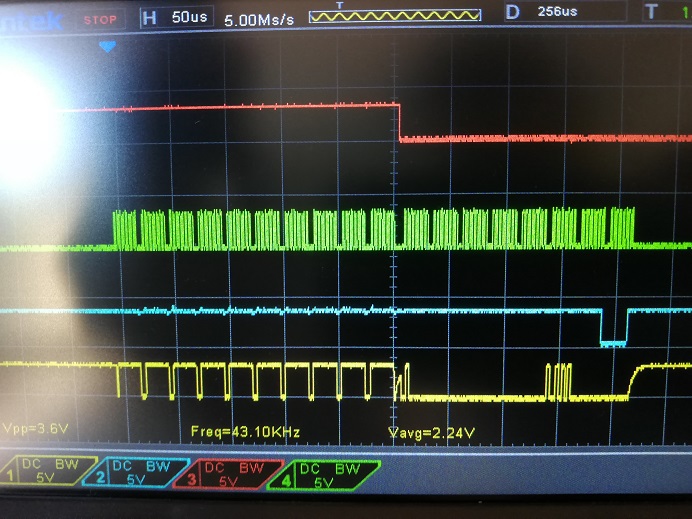

I am communicating with an SD card via the SPI protocol through the SSI interface.
After I send my command frame to the SD card via the MOSI line, I need to provide an additional 16 clock cycles so that the SD card can send a response byte back via the MISO line.
So far, I have been making those 16 additional clock cycles by transmitting two bytes of 0xFF.
The problem is, since the TM4C123GH6PM uses a common FIFO for transmitting and receiving, the data I intend to receive is always overwritten by the transmitted 0xFF. Every time I attempt to store the FIFO content into another buffer, I store the 0xFF that I am transmitting.
So, my question is: How can I provide those additional 16 clock cycles without the TM4C123GH6PM putting data into the FIFO?
See attached image. CSCLKMISO, MOSIThe cyan MISO line contains the data (0x01) that I want to store, but it is always overwritten by the yellow MOSI line's data (0xFF).

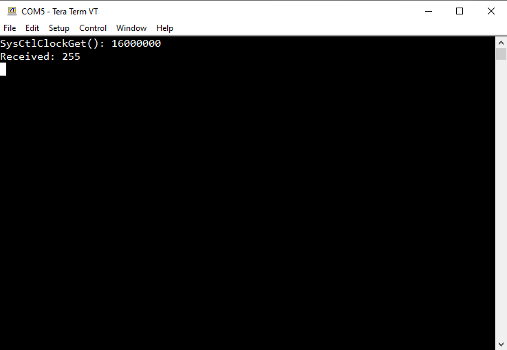

    I've also attached a zoomed-out view of my captured waveform for your reference. The last two sets of 8 clock cycles are necessary for the SD card to send back the 0x01 that I am trying to capture in RxBuffer.
    But after the execution of the aforementioned code, I am still getting 255 in my RxBuffer instead of the desired 1.
  • What is happening is that you are not properly flushing the RX buffer. You have loaded the TX buffer and then do:
        // Read out all unwanted data from receive FIFO until it is empty
        while (SSIDataGetNonBlocking(SSI2_BASE, &RxBuffer)) {
    The problem is that the while loop executes much faster than the SSI transmission. Perhaps one or two bytes have been transmitted and the same number received, but while the third byte is transmitting, the loop sees the RX buffer as empty and exits the loop.
    The simplest solution is to pair every SSIDataPut() with a blocking SSIDataGet(). That way you make sure the RX buffer is empty before you start the next transmission. It has the added benefit that you no longer need to call SSIBusy() because the SSIDataGet() function will not return until the SSI transmission has completed.
    Alternatively you can do the while(SSIBusy()) loop before you do the SSIDataGetNonBlocking() loop. You need to be careful that you don't overflow the RX FIFO. I don't see any real advantage in this method.
