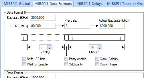

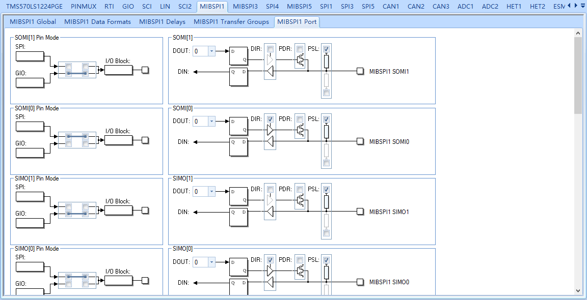

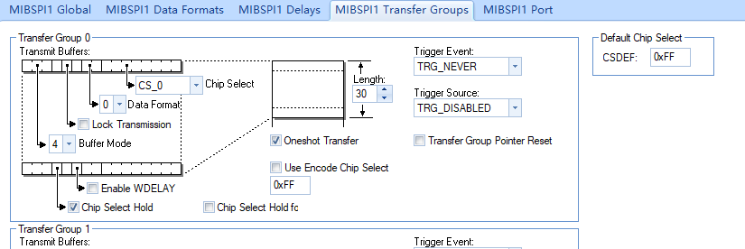

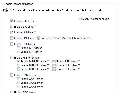

When I was programming TMS570LS1224SPI, I found that the clock signal of the development version was always low, and the output of SIMO and SOMI lines was also fixed. Here is my configuration section。
The signal waveforms I observed on the oscilloscope are as follows:
And I had the same problem trying I2C programming with this board before. I hope I can get guidance on how to solve this problem.
Thanks!
