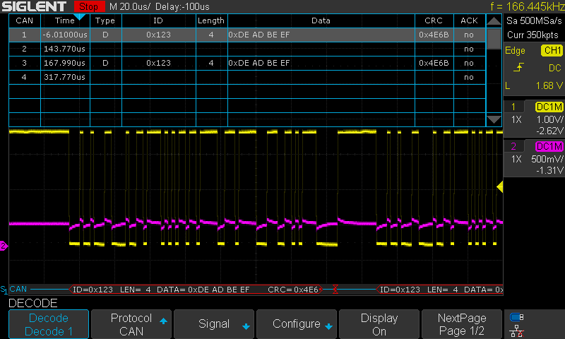

I currently have the launchpad connected to a WaveShare CAN device stuck in a breadboard.  It seems to have a 120 ohm resistor on it and the other 120ohm resistor is on the other side of the cable.  The other end of the cable is plugged into a PEAK USB to CAN adapter.  Both sides are setup at 500k and I use the cansend command on my PC to send 123#DEADBEEF.  However upon hearing this the TM4C begins repeating as fast as it can: "CAN interrupt 0x8000 0x65" I think indicating that there was a Bit 0 error.
Searching around I found:
Check your resistors - Good, pretty sure
Check your bitrates - Good
Scope CANH and CANRX - Both can be decoded by my scope
Does anyone have any ideas?

    Can you catch the first CAN frame sent by the PC after the EK-TM4C123GXL has been reset? Look closely and verify if the TM4C has acknowledged the frame. The Bit 0 error means that the CAN module intended to drive CAN TX low, but did not see a corresponding low on CAN RX. When sending a frame from the PC, the only low driven by the TM4C would be the acknowledge bit. It would be best to put the scope probes on the EK-TM4C123GXL CAN TX and CAN RX pins. If this does not make sense, try attaching a scope shot of the first CAN frame.

    I don't think the TM4C is acknowledging the frame.  So says the protocol analyzer on my scope and I think wireshark captures a frame where Linux complains about this.  As well there doesn't seem to be RX line involvement on the scope (pink).  It doesn't bother decoding the payload of an ERR frame (0x00 30 00 00 00 00 00 00) but no ACK has a similar number in the kernel.
  • Would you please clarify if the pink RX signal is at the EK-TM4C123GXL CAN RX pin? If that is the case, you have a hardware problem. Which pins on the EK-TM4C123GXL are you using for CAN0RX and CAN0TX?

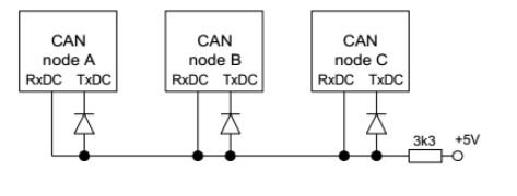

  • Hi Adam,
      Did you have a chance to try the simple_rx.c and simple_tx.c examples? They are found in <TivaWare_Installation>/examples/peripherals/can directory. These are proven examples. You can configure one launchpad to do the TX and another launchpad to do the RX. If you can get this to work then I think it will help you debug your current problem.
     For two nodes with short distance it is even possible to use the diode in place of the CAN transceiver. Below is an example diagram.

  • Adam,
    I took your project and ran it on my EK-TM4C123GXL launchpad. I had to change the include file path and library paths as your paths were not standard. It runs on my launchpad.
    Would you please provide scope or logic analyzer shots of both PB4 and PB5? Note that if PB4 (CAN0 RX) is low, you will not get anything out of PB5 (CAN0 TX).
