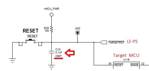

EK-TM4C123GXL: Program doesn't start on power on, only when flashed/debugging or resetting with a button
Part Number: EK-TM4C123GXL
So I haven't noticed this before but everytime I start the tiva board, the code does not seem to work. When I debug it or reflash it, everything works as expected. I also don't have the issue if I power on and then press a reset button. What could be the issue? Let me know what information I could provide for resolving the problem.
I am using UART ISRs for sensors and one of them is to communicated with a BeagleBone. Below is my startup_ccs file:

    Staff/I (outsiders) 'feel your pain.'
    Following approach is suggested:
    • Kindly substitute one of the vendor's basic/simple projects - noting if this (failed Reset) condition continues - this discovery proves key!
    • Normally the 'Start-Up' file manages the MCU's Reset.    While it 'looks good' - might you replace it (start-up file) with a fresh one - then add your 'file specifics.'
    • You note a 2nd (more powerful) MCU board:
      • have you (recently) checked to insure that a proper 'common ground' exists between both boards?
      • have you measured the voltage at each board - when 'in operation' - to confirm that (both) are being adequately powered?   (Stealing power from the LPad may prove insufficient)
      • kindly test & then describe the results when you, 'Break all connections between the 2 boards.'    (we seek to run the LPad alone!)
    • We've attached a schematic - have you made any connections to 'J2-5' - which (either) imports or exports your LPad's Reset Activity?
    • The LPad 'saves' the use of a capacitor (to ground) at the MCU's Reset Input - 'much minimizing' the effect of the board's 'Power-On' Reset.   Should all else listed here fail - and you have the skill & experience - you may add a 0.1µF ceramic cap to C13's board footprint - or add it such that it contacts J2-P5.
    • As always - you can reduce the likelihood of dreaded 'single-board anomalies' (which 'eat' helper's time/effort) by acquiring & then testing a 2nd board.  (LPad here)
    Again that top bullet point proves easiest - and will provide key diagnostic feedback.     Note that we have >100 of these '123 LPads - all working - & all minus C13...
