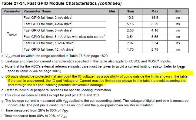

Is product quality assured when some siganls (e.g. CCS, UART, GPIO, reset) are applied from external device to TM4C129 while the power of TM4C129 is off?

      Yes, there could be irreversible damage to the device if the I/Os are powered while the device is un-powered. Please refer to the datasheet for details. There are several notes that talk about this. Below is one excerpt in the electrical section.
  • Holiday Survival Greetings, Charles,
    Staff/I greatly 'second' your advice - while it IS convenient to create such a 'staggered power' system - our long experience (>20 years) finds that 'Issue Frequency' rises - under such conditions.   (and the failures may be gradual & incremental - building w/the passage of time...)
    An 'eased method' of preventing such 'Staggered Power' issues is by 'Powering all interconnected boards/sources from the same (adequate) power supply!'    (or by 'Enabling & Disabling' individual, "Board-Level Supplies" via a common signal - insuring that the unpowered MCU is free from unwanted (and also patently unproductive) voltage arrivals...)
