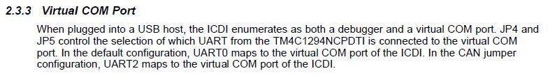

      You are using the EK-TM4C129EXL launchPad, correct? Only UART0 and UART2 are connected to the virtual COM port of the ICDI. If you are using the UART7 without an external USB to serial adapter such as FT2232H from FTDI then it will not work. If you have an USB to serial adapter connected and is seeing garage then please check if you have matching parameters like the baud rate, stop bits, parity bit between the two nodes. Do you see the same problem with other UART modules? If you are seeing the same problem with other UART modules then it is likely your port settings are not matching. I will suggest you also try the TivaWare uart_echo example. It is using UART0 in the example. But if you are seeing the garbage on your terminal window then it kind of confirm the incorrect port setting The example uses 115200 baud rate with 8 bit data and 1 stop bit with no parity.
  • Ahmad,
    Appears CCS terminal is displaying hexadecimal as higher ASCII code set symbols. Following Charles great advice to use (virtual com) you can then use Realterm (github.com) or perhaps older Putty to display hexadecimal numbers on the host computer.
