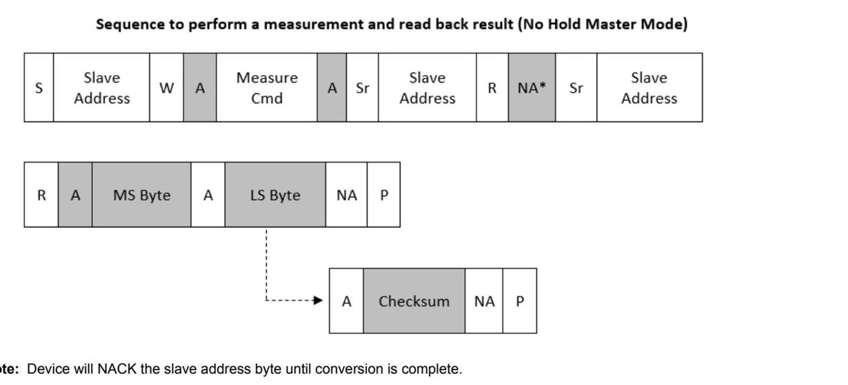

I have a demo board setup with TM4C123G micro connected to SI7006-A20-IM1 Temperature/Humidity sensor and trying to read data from the registers but getting wrong values. The read method of "No Hold Master Mode" requires polling an NACK until the ACK is received from the sensor so the correct data can be received. I wanted to know how this can be done using the TivaWare 2.1.4.178 version I2C API calls in the documentation or if another method is required to accomplish this. I am using CCS9.

      Here is a SI7006-A20-IM1 I2C transaction sequence for the No Hold Master Mode. In this case, the device will NACK the slave address byte until the data is complete. You can call the TivaWare I2CMsterErr() and poll for I2C_MASTER_ERR_ADDR_ACK and wait until the flag is cleared by which time you can re-issue the slave address byte again. This is a polling method. Another method is to use interrupt. When NACK is received by the I2C master, it can cause an interrupt to the processor. The processor can re-issue the slave address byte based on the interrupt request.

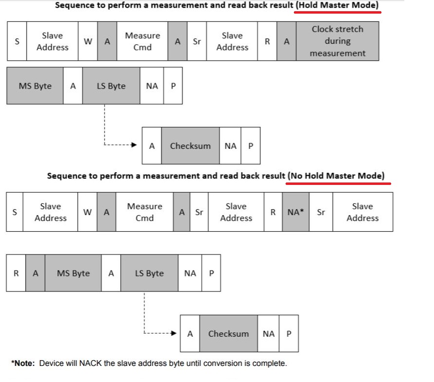

    My group proposes instead - poster's switch to "Hold Master Mode" - which substitutes 'clock-stretching' in place of 'repeated polling.'     This method seems to be far less demanding - almost 'automatic' - as the requirement for polling is eliminated.    Presented below is a, 'Contrast of each method' - our vote goes to this 'Hold Master Mode!'    (which BTW - enables the acquisition of Temperature just after Humidity measurement.)

    Gurlz & I have the opinion that, "ONLY by issuing ANOTHER Slave Address" - can a 'FRESH ACK or NAK' be obtained!    Our logic is that there exists 'NO METHOD' for the Slave to 'magically' present its (NEW) ACK - until (another) Slave Address Transaction has arrived.
    To use 'your words' - it must be that (both) the ADRACK & DATAACK Bits - obtained via call to, 'I2CMasterErr()'  (must) STICK until a new Slave Address Transaction is launched.    (think of it - how possibly can the Master (MCU) detect the Slave's 'CHANGED' ACK/NAK Bit .. without Resending the Slave Address Sequence?)    (which only then enables the Slave Device to respond...)

    May we respectfully disagree?     Is not the intent of the 'clock-stretching' to, "Eliminate that waiting for the Slave to complete its processing?"     You  may note that the diagram we presented removes the asterisk and related 'Note' (which directed the repeated polling requirement) - when the "Hold Master Mode" is selected...    It is for that 'simplicity' - bordering upon automation - that we've recommended "Hold Master Mode" as superior...
    This may rise to the level of improved explanation w/in the (pardon) 'Teased/Pending' API Updates...   (i.e. "I2CMasterErr()" is (only) a, 'One & Done' function - thus cannot be (productively) called repeatedly (by itself, alone.)    Existing API nowhere provides this (necessary) level of detail...)
