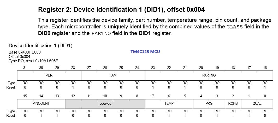

    Historically Register bits were most often "Inactive" when defaulting to '0.'    This was achieved via the Processor/Controller's biasing - and usually could be toggled by the user via software settings.   The books noted earlier stated that the Register Bits which were, "Read as '1' were "More easily recognizable" and thus likely to be 'Active' when set to that '1' state.   Thus your 'answer' is - as you well thought - 'Underlying hardware!'     However - though rare - a few compilers, "Did have the ability to automatically (i.e. w/out user intervention) alter certain Registers - this to: 'Correct Mistakes' and/or 'better mesh w/majority user needs!'
    To illustrate - we include a '123 MCU Register - which reveals a 'mix' of '0s & 1s' (as default) and which (clearly) complies w/your, 'Underlying Hardware' intuition.    (Key bits must NOT be 'alterable' - either deliberately or thru program/user 'mistake!')

    Normally reserved bits are forced to 0 by hardware. There is no physical flip-flop associated with a reserved bit. You can think of them a tie-off to ground. Cb1 brought the Device ID register as an example. This is another type of 'logical' register that is not implemented using flip-flop. Rather than tied-off to 0 like the reserved fields, they are tied to high or low per their intended values.
