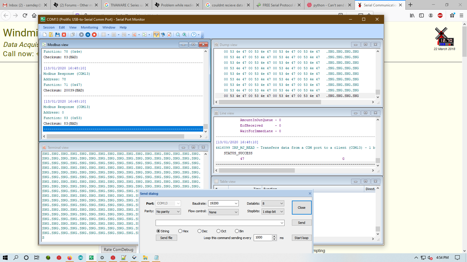

 I am working Communication protocol , Using UART1(RS 485) for communicating with external device. I have checked loop back , TX and RX configuration done successfully because getting loop back character. when i sending data to external device UART1 transmitting data successfully, External device HMI display the data which have received from UART1(TM4C123GXL).   If i am sending data through HMI , i couldnt get data in TM4C123gxl side. Last two days i hardly working for find this mistake,if any given solution its very helpful for me.

Serial Monitor Output window
