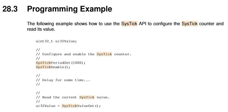

    Here's the Systick example - clearly illustrating staff's claim:
    Our poster here did 'everything right' - yet the Guiding Examples (ALL of them!) neglect this key requirement - and "Ralph's Sticky Factor" explains why 'Success' may be temporary!     Simple addition of, "Insure that a call to,  "IntMasterEnable()" (not shown in the example code, below) must appear (somewhere w/in your code) if & when interrupts are deployed..."
  • Hello cb1,
    I'll discuss w/ Bob & Charles where we could improve this, but the examples that are lacking it don't use interrupts at all which is why the call is excluded in them. Any TivaWare example that uses interrupts does show the IntMasterEnable() API being called.
