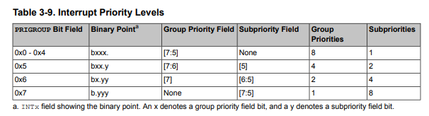

  • There are three bits on the TM4C devices that can be used to set the priority. They are the three most significant bits of a byte so the valid priorities are:  0x00, 0x20, 0x40, 0x60, 0x80, 0xA0, 0xC0 or 0xE0. The three most significant bits of each byte are 0, 1, 2, 3, 4, 5, 6 or 7. Now whether the bits determine the group priority or sub-priority is dependent on the call to  IntPriorityGroupingSet(). You pass the number of bits that you want to be used for the group priority. Since there are only three bits available, the valid options are 0, 1, 2 or 3. By default all three bits are used for group priority, there are no sub-priorities. Here is a table from page 171 of the datasheet that shows the tradeoff between group priorities and sub-priorities:
    Now back to your question. If you call  IntPriorityGroupingSet(2), you have allocated 2 bits to group priority. That leaves only 1 bit for sub-priorities. That means you will have 4 groups (2^2) each with 2 sub-priorities (2^1). If you want 4 sub-priorities, use  IntPriorityGroupingSet(1). That allocates one bit to the group priority (giving 2 groups) and 2 bits to the sub-priorities (four sub-priorities for each group).
