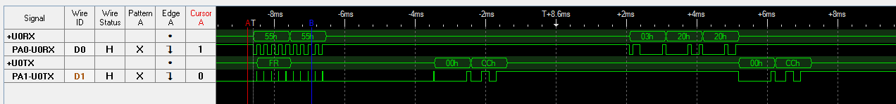

  • Bob,
    The UART is functional. See captures below.
    Bryan
  • OK, I think I am beginning to understand what is going on. Since you are using a 16MHz crystal, you need to autobaud. You first need to send 2 characters of 0x55, then wait about 8mS for the device to respond by changing the TX pin to an output and sending 0x00, 0xCC. I used the LM Flash Programmer Utility to create the proper sequence. Here is what I captured on my logic analyzer during a successful autobaud and program.

  • Sending the 0x55 twice resolved the problem. I did not see this mentioned in the ROM users guide. I would suggest clarifying the auto baud in the users guide for future use.
