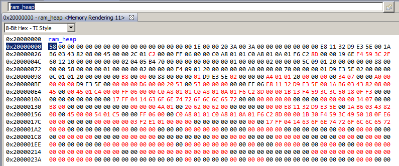

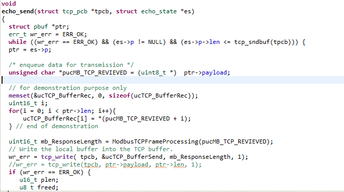

    I played around the heap & stack sizes (1024 & 4096 respectively) in the options with same result, also i found wear thing that despite the heap size was zero, the compiler set value for it and assign memory space in the RAM as in the picture below, also i'm attaching a print screen from the code which i use to catch the data pointer from Ethernet packet.

    // heap print screen despite it's configured to zero size.
    // code print screen
      You code seems to have some similarity to the example created by Adam_Dunkels. See below code snippet and the link to the source file. If you use Adam Dunkels's code as it, do you see problem. You also said you referenced the enet_lwip. Do you see the same problem running the example?

    You can look at the .map file to see what symbols are being allocated at these RAM locations in your screenshot. You look like you are creating Modbus over TCP. We don't have any expertise and examples with Modbus. If you are using the Modbus library from some other vendor I will suggest you contact them and also LwIP forum for support. At this moment, I don't think your problem is related to the heap size since you have played with them and has no effect.
  • Hello Charles
    Thanks for your support, the problem was in my Modbus API program.
