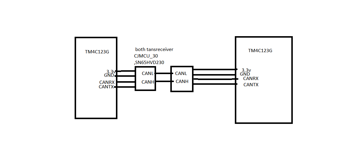

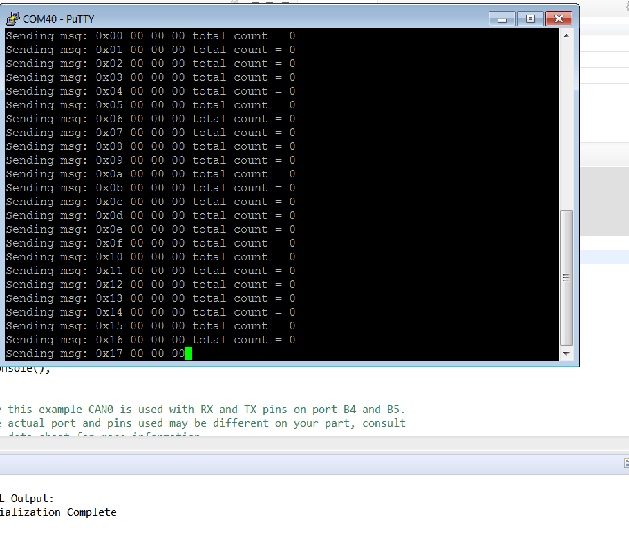

I am using 2 TM4C123GH6PM boards and  CAN0 and UART0 of both the boards. I have taken CAN bus  example from Dk-TM4C123G
board example. I have deleted the LCD part because I don't need this for my testing.
I am using 2 CJMCU-30 transceiver having IC SN65HVD230.
I am not getting output at all.
I have checked hardware connection, they are correct and the code is also error-free
and debugging properly.
I have changed CAN0 pins then also I am not getting
the output.
Please help me to find the solution to this problem

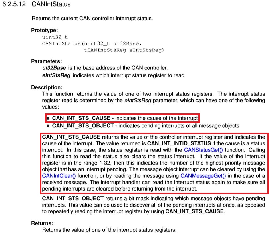

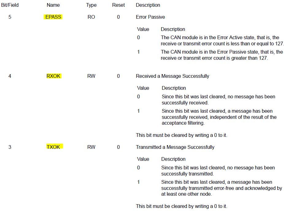

      Can you try the attached can_simple.tx.c example or compare with your existing one? I assume you have proper termination resistance (i..e. one 120 Ohm resistor at each end of the bus) between the CAN_H and CAN_L. This is especially critical for long distance.

  • Earlier you reported, "I have checked hardware connection, they are correct."
    A schematic drawing revealing "ALL of your connections" was requested:
    • MCU1 to CAN Xcvr1
    • CANBus1 to CANBus2 (differential signal side)
    • MCU2 to CAN Xcvr2
    Providing this requested information reduces "guesswork" forced upon your 'helpers.'     And gains you "Additional Eyes" to review your hardware connections.   (earlier deemed "correct" by you)
    You most recently report receiving, "Error - cable connected?"    This increases the importance of your (still missing) schematic diagram.
    Note that you earlier reported, "I am checking output on Serial Terminal (putty)."    Yet the output of (most all) CAN Xcvrs is "unlikely" to be compatible w/your (assumed) PC configured as a serial terminal.    (the PC almost surely 'expects' a USB connection - not provided by most all CAN Xcvrs!)
    Unexplained is your action which moved your results from, "No Output" to (now) "Error - cable corrected!"    What had you done to achieve 'this' (first time) new output?
    Scope captures of the earlier listed CAN signal lines (at each MCU & across the CAN Bus) have (not) been supplied.    These prove crucial in "Quick & Eased" remote diagnosis of most any serial bus...
    I am sending you a rough schematic diagram  these are my connection with transceiver, these are properly connected as CAN0RX to PE4 of TM4C123G
    CAN0TX to PE5 of TM4C123G
    3.3v and GND connections
    and CANL to the other transceiver CANL, CANH to the other transceiver CANH.
    Are there other connections?
    Sorry, I don't know much about it.
    please guide me properly to solve this
    thanks and regards
    Deoyani

    this is UART0 output of one  TM4C123G board in which Simple_tx.c is loaded and in the other board simple_rx.c is loaded and it shows nothing.
    thanks and regards
    Deoyani

      If you are seeing "error - cable connected?" printed on the terminal window then the CAN kernel has detected an error. Please find out the status from the CANSTS register to determine the cause of the error. As suggested by cb1, it will be much easier to debug your problem if you have the scope to capture the CAN bus.
  • Hello Charles,
    How to find out the status from the CANSTS register?
    Can you please guide me properly.
    Thanks and Regards
    Deoyani
      Please refer to the CANIntHandler() ISR. It is calling the CANIntStatus to find out the cause of the interrupt. This function will read the CANSTS register. You can put a breakpoint at the line to find out the value that is returned from the call or simply browse the register window.

    Thanks - you did an excellent job of guiding poster (and others [especially my small group]) w/this key (insider) detail.
    Neither staff nor myself could find info re: "CAN_INT_STS_CAUSE" - as it was not listed w/in the API's CAN Defines.    We then searched 'pin_map' - again w/out recognition.
    Digging deeper - we found its description ('buried' w/in the API) - and believe it best to "share" that key find w/poster & interested others:
    This API screen cap (below) illustrates our (and others) difficulty in such critical recognition:
    Do note that (entire staff here) was 'lost' - until our 3rd search (after failed search of pin_map.h & TM4C123 manual) uncovered this (well hidden) eIntStsReg parameter.   (found w/in ONLY the API library.)   As the understanding of this parameter is critical - might it be best to, "More noticeably present it?"    (of course not your job nor were you a cause agent - yet 'hiding' such data is unlikely to 'boost' MCU Sales...)
  • Hi cb1,
      Thank you for your feedback and your presentation of the API function. I also found the below notes in the datasheet that will provide additional clarify to the poster.
    The interrupt identifier INTID in the CANINT register indicates the cause of the interrupt. When no
    interrupt is pending, the register reads as 0x0000. If the value of the INTID field is different from 0,
    then an interrupt is pending. If the IE bit is set in the CANCTL register, the interrupt line to the
    interrupt controller is active. The interrupt line remains active until the INTID field is 0, meaning
    that all interrupt sources have been cleared (the cause of the interrupt is reset), or until IE is cleared,
    which disables interrupts from the CAN controller.
    The INTID field of the CANINT register points to the pending message interrupt with the highest
    interrupt priority. The SIE bit in the CANCTL register controls whether a change of the RXOK, TXOK,
    and LEC bits in the CANSTS register can cause an interrupt. The EIE bit in the CANCTLregister
    controls whether a change of the BOFF and EWARN bits in the CANSTS register can cause an
    interrupt. The IE bit in the CANCTL register controls whether any interrupt from the CAN controller
    actually generates an interrupt to the interrupt controller. The CANINT register is updated even
    when the IE bit in the CANCTL register is clear, but the interrupt is not indicated to the CPU.
    A value of 0x8000 in the CANINT register indicates that an interrupt is pending because the CAN
    module has updated, but not necessarily changed, the CANSTS register, indicating that either an
    error or status interrupt has been generated. A write access to the CANSTS register can clear the
    RXOK, TXOK, and LEC bits in that same register; however, the only way to clear the source of a
    status interrupt is to read the CANSTS register.
    The source of an interrupt can be determined in two ways during interrupt handling. The first is to
    read the INTID bit in the CANINT register to determine the highest priority interrupt that is pending,
    and the second is to read the CAN Message Interrupt Pending (CANMSGnINT) register to see
    all of the message objects that have pending interrupts.
    An interrupt service routine reading the message that is the source of the interrupt may read the
    message and clear the message object's INTPND bit at the same time by setting the CLRINTPND
    bit in the CANIFnCMSK register. Once the INTPND bit has been cleared, the CANINT register
    contains the message number for the next message object with a pending interrupt.
    The datasheet has the full description of all the error flags and LEC code that match with the API.
