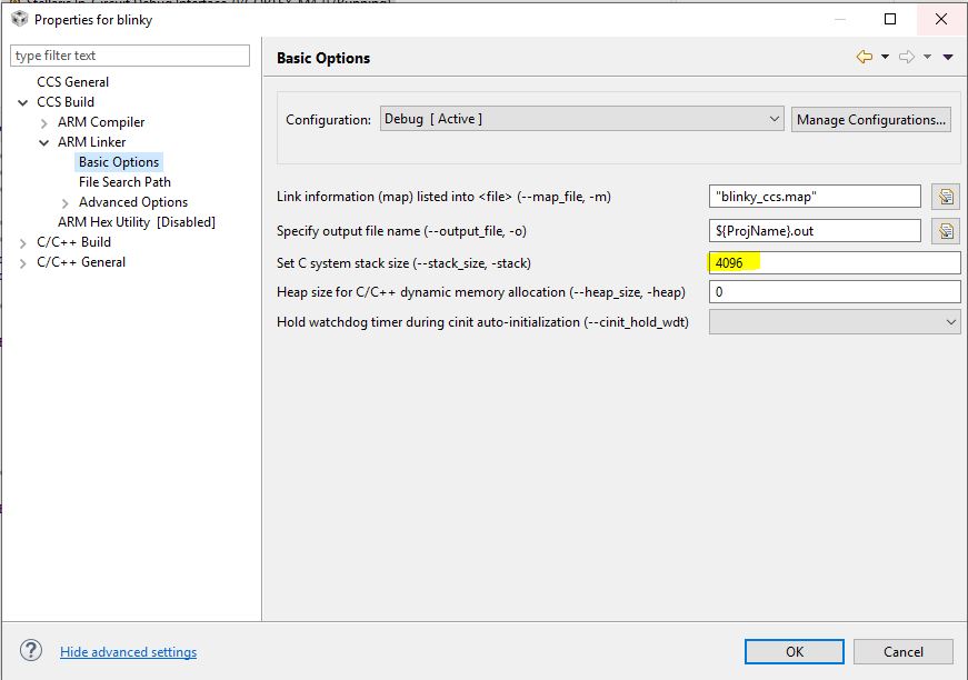

  • How did you change the stack size?
    Did you change in both areas like below example?
     Other than the stack size I really don't know what could have caused your problem. Normally, the hard fault is mostly related to insufficient stack. Looks like not in your case unless you didn't increase stack size correctly. Please note that our expertise is not on the 3rd party software such as LwIp.  In the meantime, i will suggest you follow this app note http://www.ti.com/lit/an/spma043/spma043.pdf to diagnose the hard fault problem.
