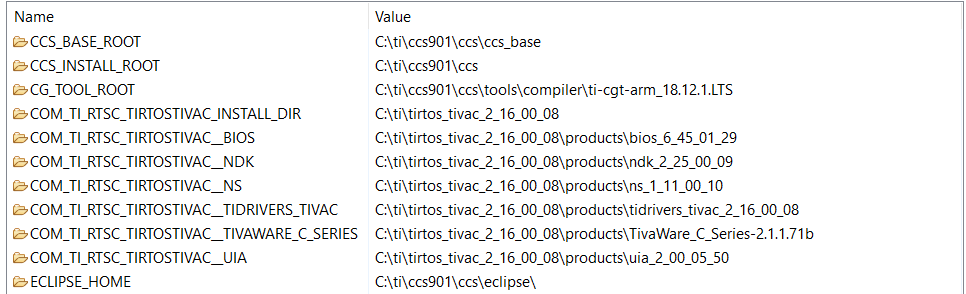

  • Hello Ralph,
    Thank you for the clarification. PFA resources that we are using inour project; please cross check
    We are using USB in our product so based upon our earlier discussion, for USB library we should stick to this path C:\ti\tirtos_tivac_2_16_00_08\products\TivaWare_C_Series-2.1.1.71b\usblib\ccs\Debug right?  Also if we plan to use any other library in future; it should be used from this location  C:\ti\tirtos_tivac_2_16_00_08 or C:\ti\tirtos_tivac_2_16_00_08\products\TivaWare_C_Series-2.1.1.71b\  only. I know this question sounds stupid; but wanted to double check.
    Thanks & Regards
    Abhijit
  • Hello Abhijit,
    You should include usblib.lib into your project under: Build -> ARM Linker -> File Search Path
    There is a list for 'Include library file or ...' and you can link the usblib into your project there.
    I would imagine you can do so using this (provided I did not make a typo for "COM_TI_RTSC_TIRTOSTIVAC_TIVAWARE_C_SERIES'):
    ${COM_TI_RTSC_TIRTOSTIVAC_TIVAWARE_C_SERIES}/usblib/ccs/Debug/usblib.lib
  • Hello Ralph,
    Thank you for your reply.
    My question was more of from TIVA C Series version point of view.  So for USB lib or any other lib, we should stick to TivaWare_C_Series-2.1.1.71b when using TI-RTOS on TM4C series microcontroller.
    I think I got the answer.
