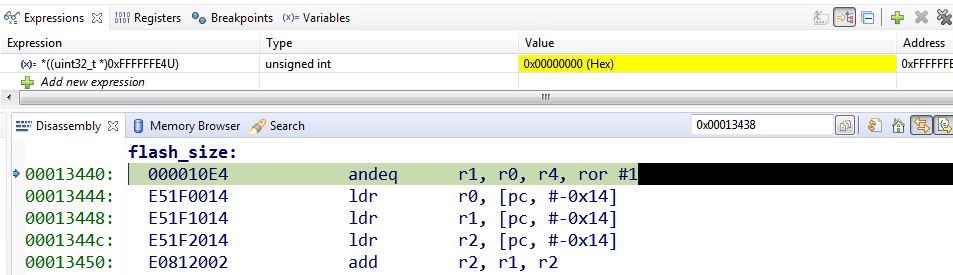

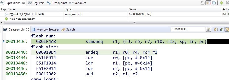

I have found that the watchdog flag is reset upon entering this RAM copying function.
I'm checking the watchdog flag in the SYS_EXCEPTION register (addr 0xFFFFFFE4). When I trigger a watchdog reset, the flag is set correctly prior to this stmdaeq function.
Then when I step pass flash_run, the watchdog flag is cleared.
why is this happening?
