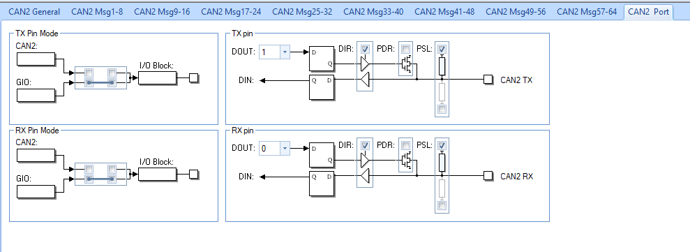

Hello everyone,
I set the setting for GIO and generate the code. I am really new to TMS570 family and my problem is how can i use this port as GIO. I mean normally, i can write gioSetBit ( hetPORT1 , 0 , 1); but for Can2 Port what can i write ?

    The CAN_RX and CAN_TX pins of each DCAN module can be used as general purpose IO pins, if CAN functionality is not needed. This function is controlled by the CAN TX IO Control register and the CAN RX IO Control register.
    You can not use GIO APIs (like  gioSetBit()) for CAN module which is used as GIO.

  • As I mentioned, DCAN TIOC register and RXOC register are used to set/clear the CANTX pin and CANRX pin (GIO mode).
    The values of the IO Control registers are only writable if Init bit of CAN Control Register is set.
    canREG2->CTL |= 0x00000001;
    canREG2->TIOC = (uint32)((uint32)1U << 18U )   /* CAN_TX pin*/
                                 | (uint32)((uint32)0U << 17U )
                                 | (uint32)((uint32)0U << 16U )
                                 | (uint32)((uint32)0U << 3U )     /*GIO mode*/
                                 | (uint32)((uint32)1U << 2U )     /*output*/
                                 | (uint32)((uint32)ti << 1U );       /*high*/
    canREG2->CTL &= 0xFFFFFFFE;
